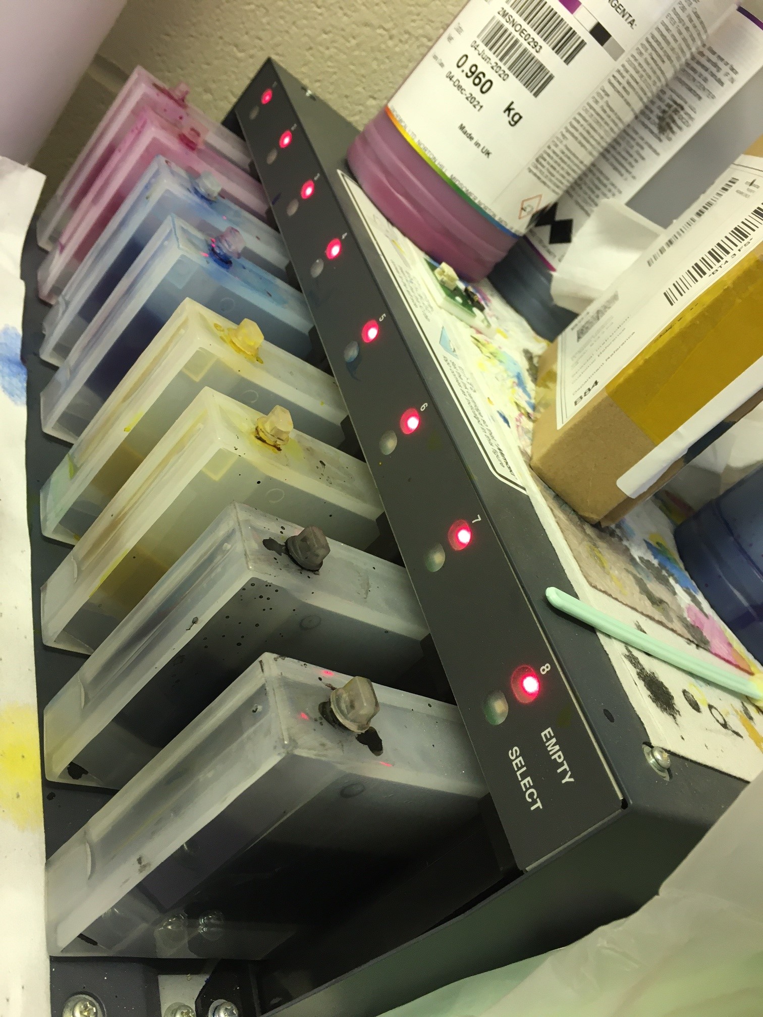

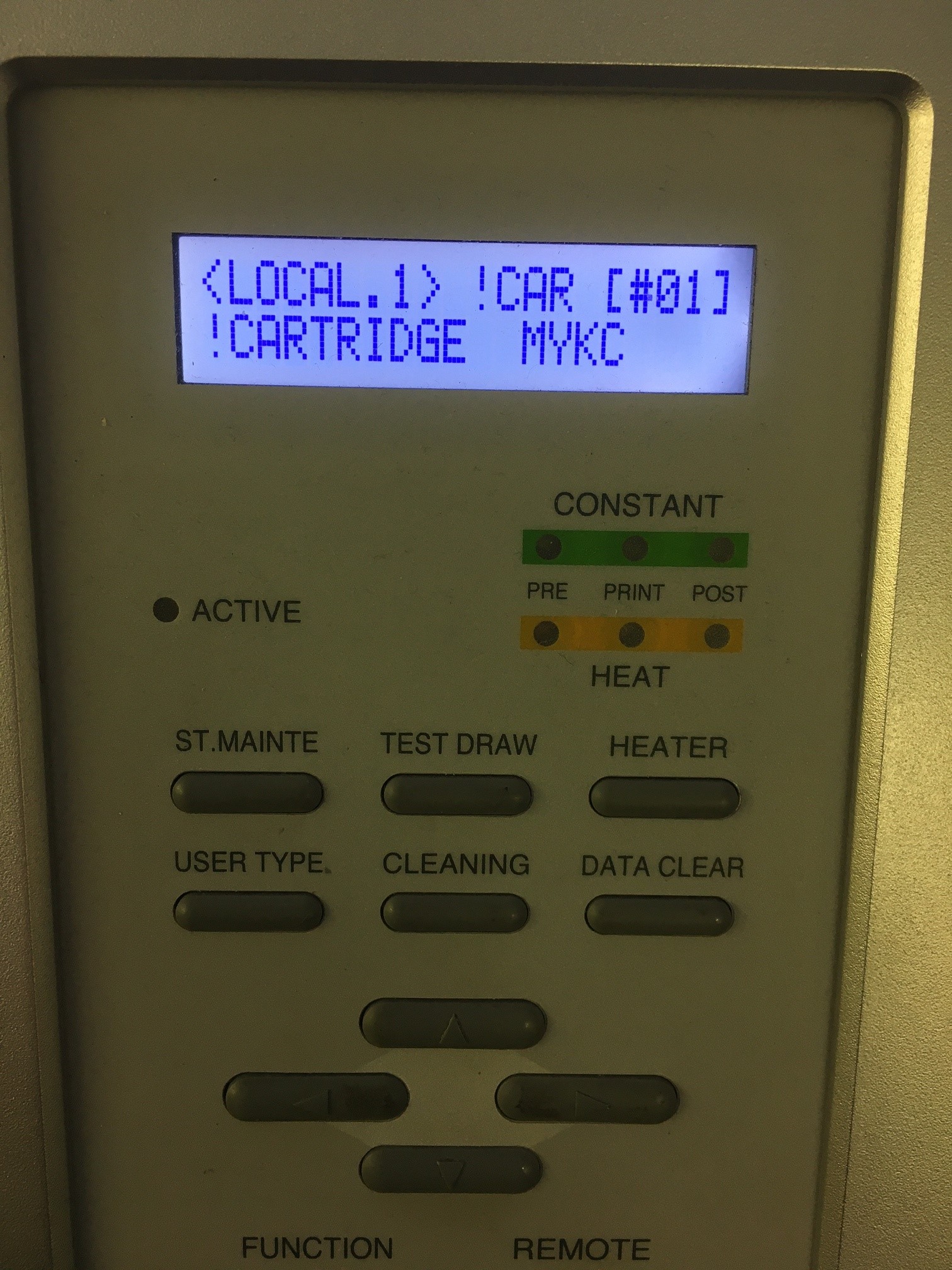

hi all, interesting read indeed, after trying to install a new unused 2nd hand generic print head which didnt work had to replace with old print head then to be faced with a line of red leds which in effect stop everything as you can't even load ink into the head.
JV33 160 on version 5firmware
now wondering am i now having to revert to oem mimaki inks , and if i do will it even work?

I got a wider CJV30-160, I´ve tried to move my CISS System to this machine, I only get two ink permanent Chips up, and two not ??!!!
BUT it was working till 2 month ago....... I already tried to buy new chips, 2 times, but still not works !?
My FW is 1.2, I´ve tried the FW Updater, but I get "you have a special firmware" message.
After reading here am a bit confused WHAT version OR IF I should upgrade if I can ?!!?
PLEASE SOME HELP AND ADVICE how to get my MIMAKI bach to printing......
I´ve inserted 2, almost empty chips, from my old and empty mimaki catridges... -1% or so..... waiting every minute that self cleaning service stops !!!
