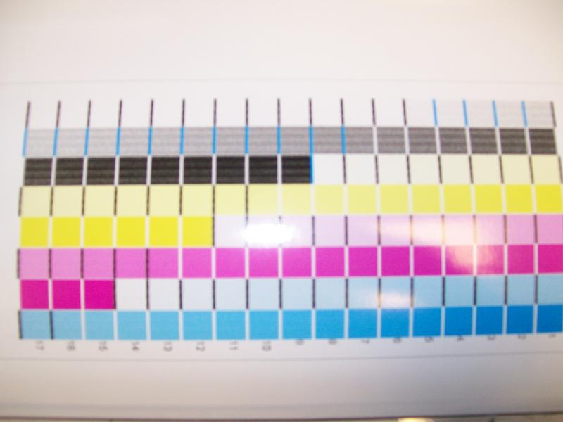

    does it look like what I have attached?
    I think I am having the same problem.
    *Notice the black swatches

    Serverjohn,
    That looks like you have having a problem with your black printhead. Are you missing nozzles when you do a test draw ? The problem I have is very sporadic, and I have vertical and horizontal lines, and sometimes missing blocks of ink as though it is being starved of ink. I found a small kink in the end of my decoder strip this morning when I went back for a once over cleaning again, I have come to the conclusion that is the root of all my issues.....

    Whoops didn't mean to hijack. I thought it was similar in that my test pattern is perfect. Just trying to help :)
