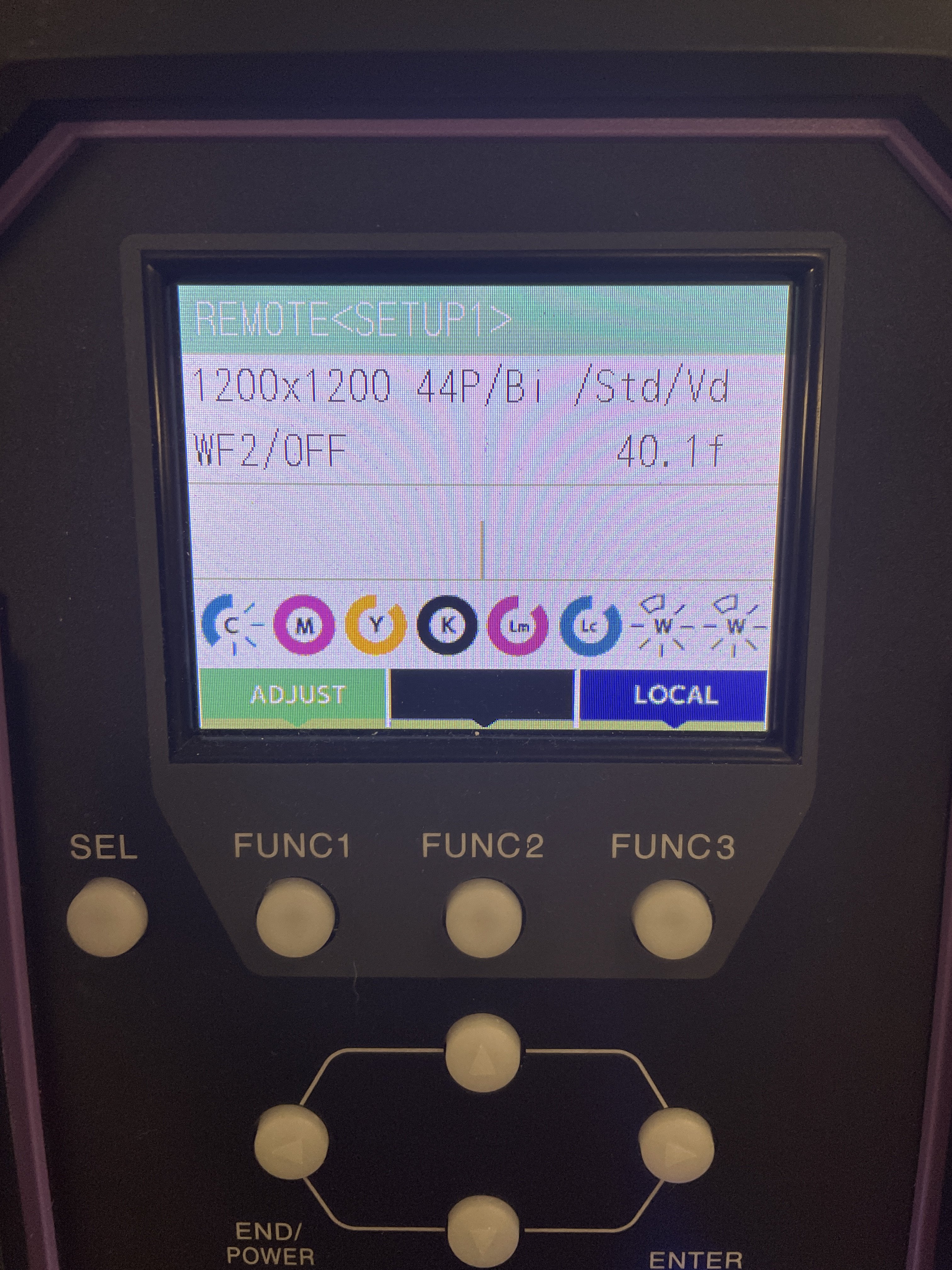

Currently 1200x1200 44 pass

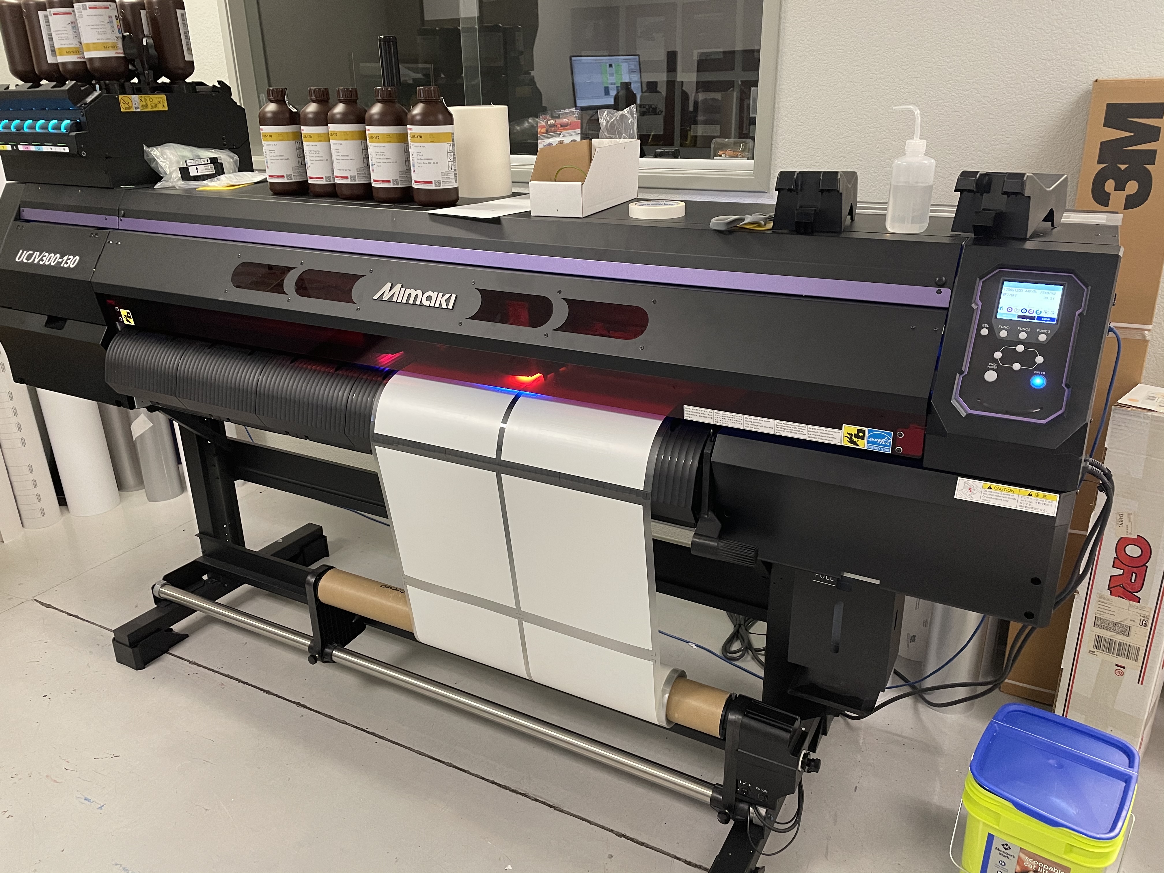

This part is both very fine detailed small writing and at same time its majority white. It is currently printing 50 x 2 so 100 pieces in roughly 24 hours. Are these settings the only way to achieve the fine details of the part or Can this be speeded up with less passes or different settings of some kind? Maintaining the quality Is priority but id like to find out if its possible to speed up production. The only way i can think of is to not uv print the white and after it prints just screenprinting the white flood last, any suggestions?

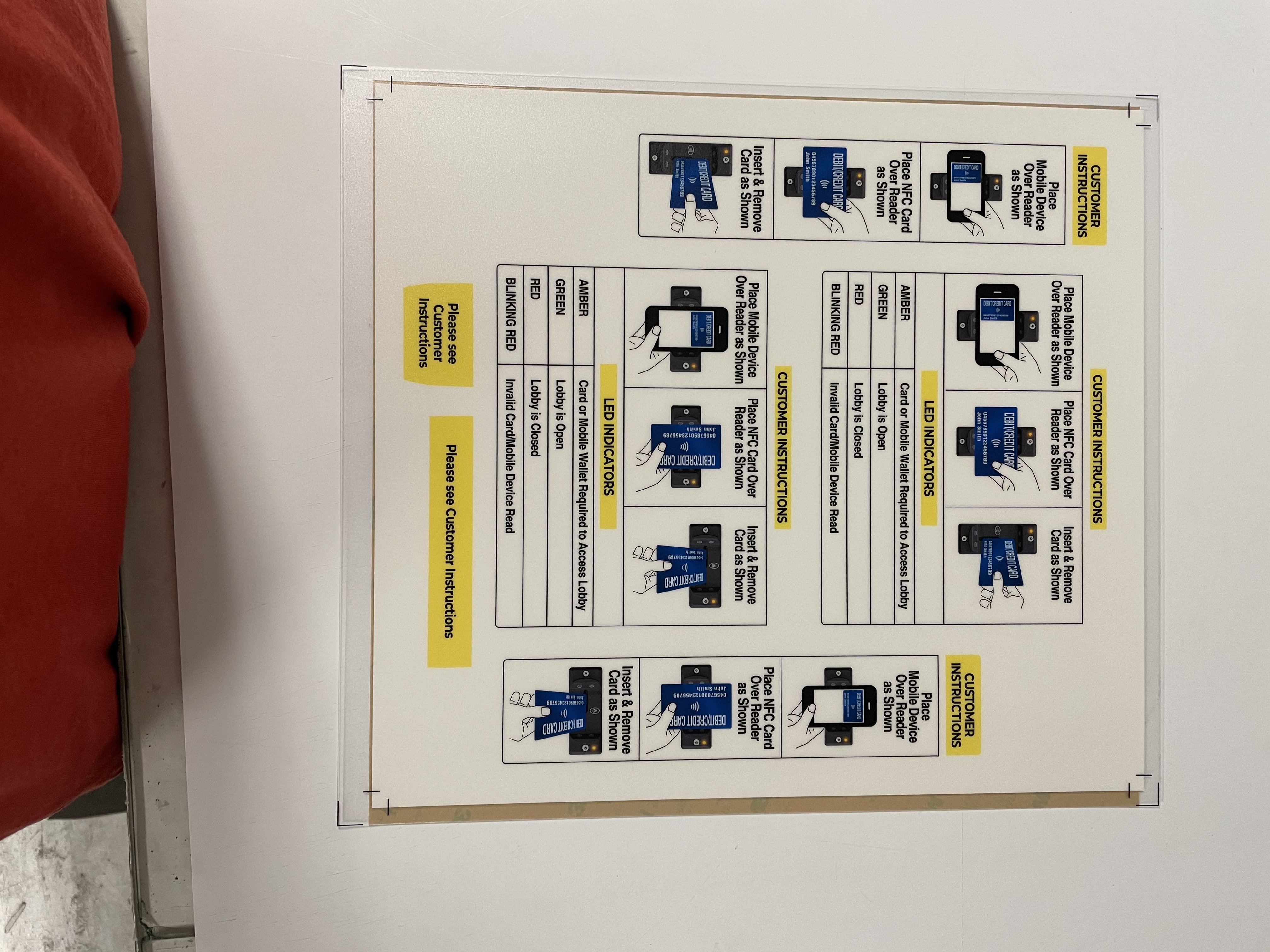

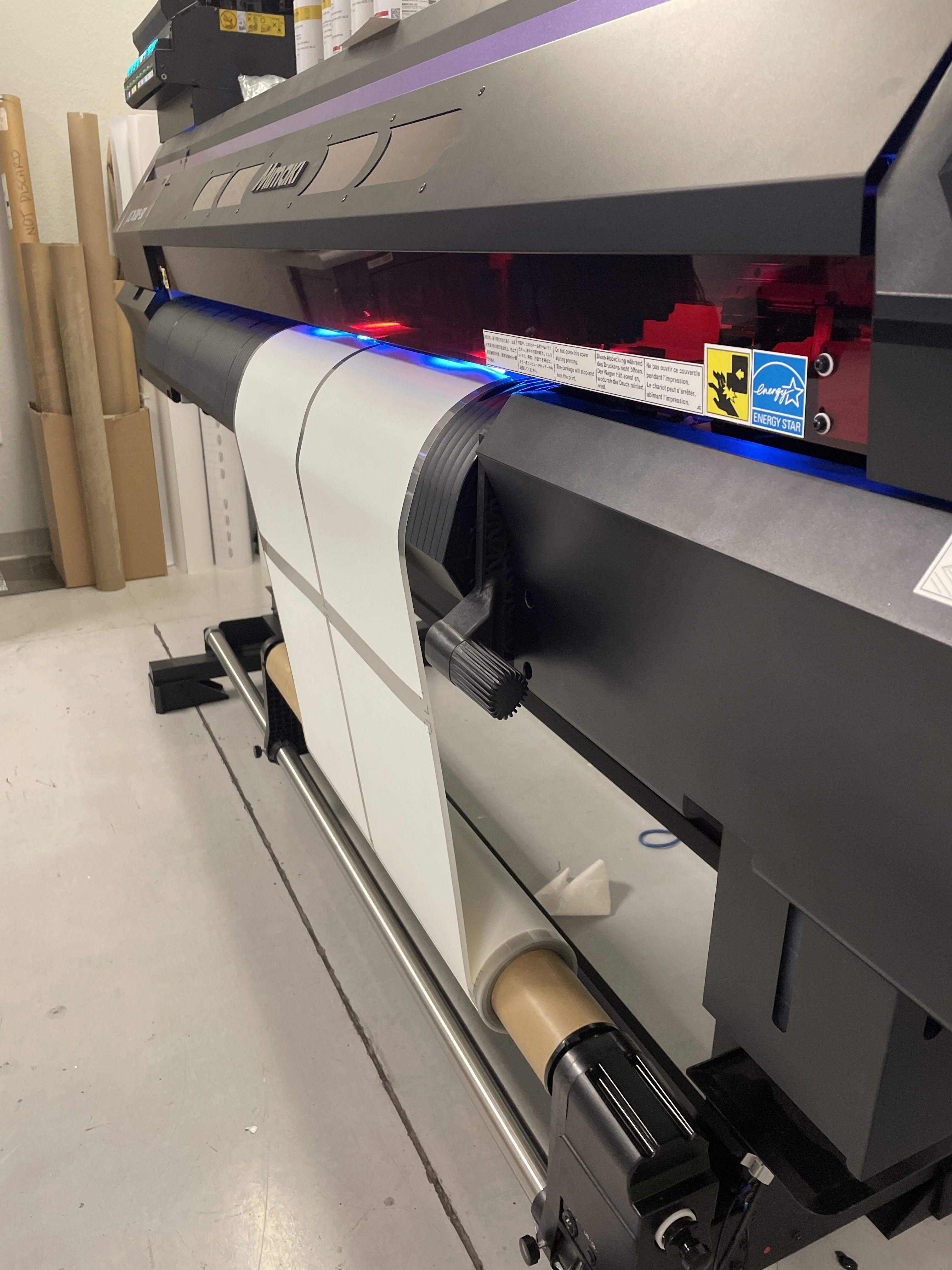

A few more pics

44 pass is very high. I'd try to find a profile that is closer to 24 pass or lower if you can get away with it. Also, that profile is also set to standard speed. You should be able to go into the RIP and change it to high speed which will make the motor move faster but you'll have to decide if the quality is still good enough for you. Make sure you get your drop position alignment spot on as that will give you th ebest chance for crisp prints even at higher speeds.

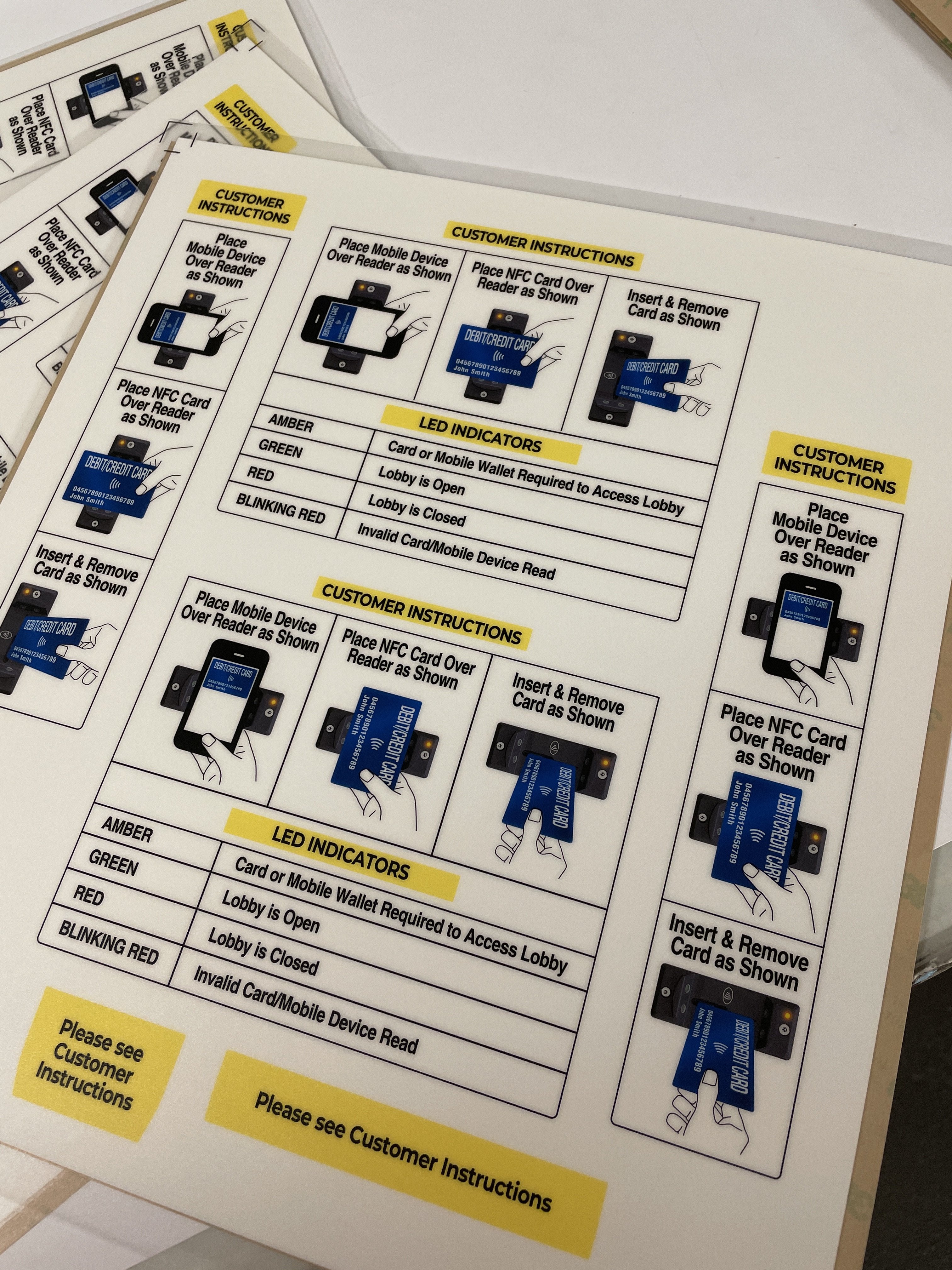

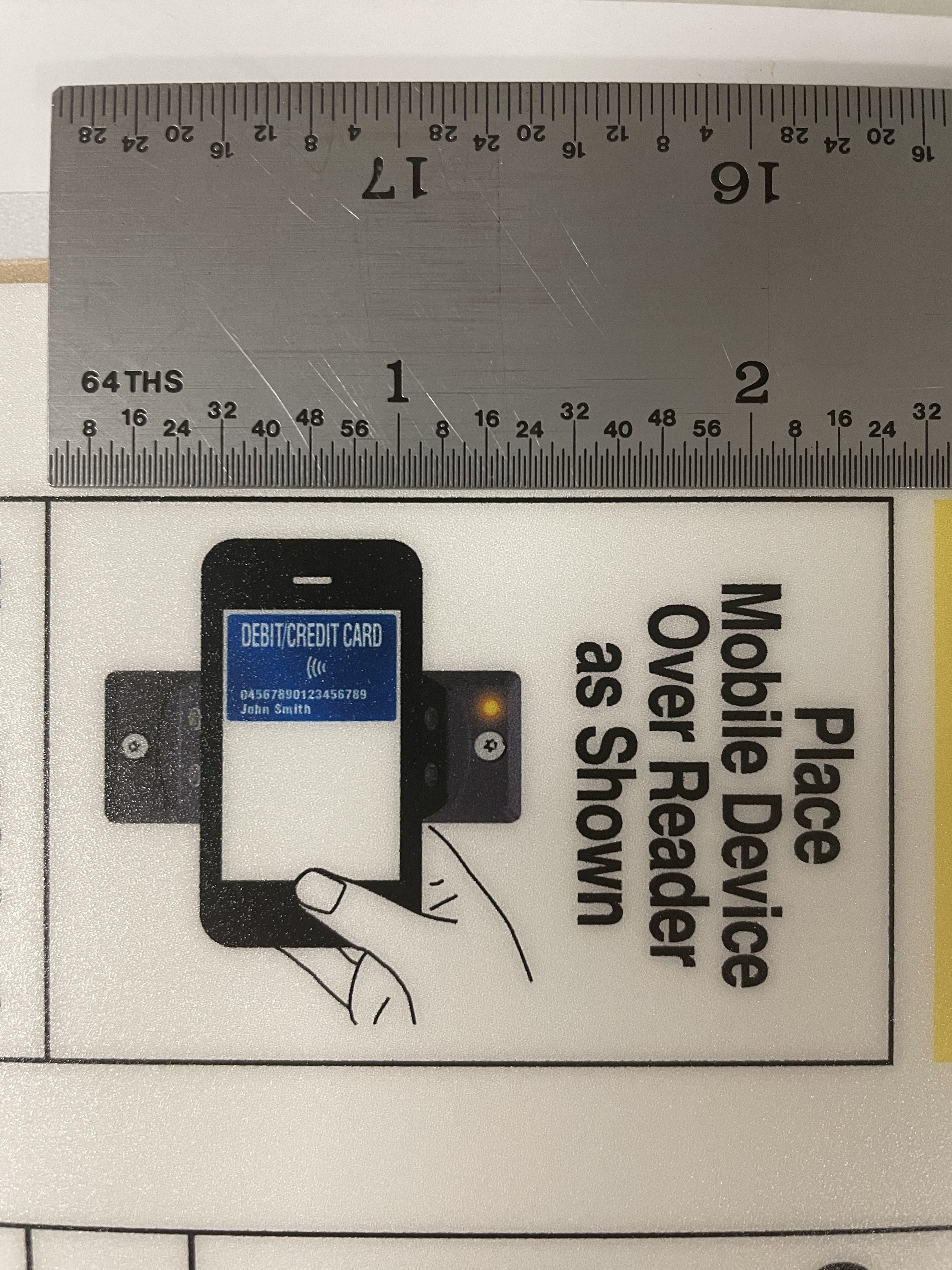

so the really the small white writing on the blue cards is like the size of your name on the front of a bank card thats not considered "that" detailed? were running the parts onto a take up roll with hundreds on it, when you say flood after are you saying screenprint or back on the mamaki uv printer somehow just printing the white?

thank you very much. The small white writing on the blue cards is very small like 6-8pt font id guess, do you think 24 pass on high speed could still produce the crisp quality? basically im trying to speed things up but not sacrifice any quality.
