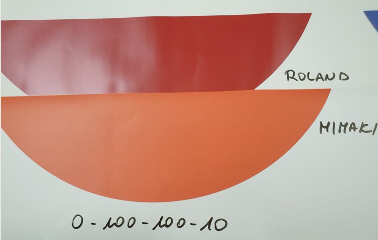

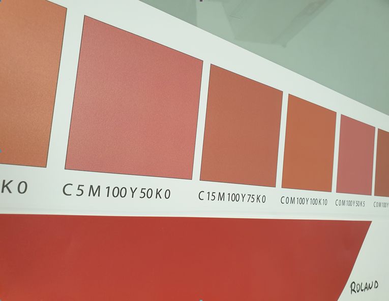

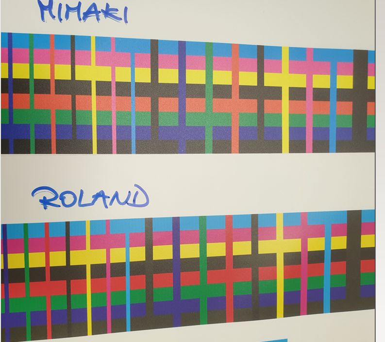

Hello,
We are having problems with the plotter : Mimaki UCJV300-160.
It is practically new and still covered by warranty.
The dealer is, as yet, unable to help.
A brief summary of our main problem is as follows:
  • The plotter will not print red correctly, the hues are faded or worse, are altered to the point of becoming literally orange, in particular at lower resolutions.
  • A Mimaki technician tried creating a custom profile to resolve the question, which was to no avail.
    (the plotter should print a full red even from the plotter’s own test print, without a custom profile)
  • Maintenance tests and an air purge have been performed on the plotter.
  • It seems that there is, at present, no Firmware update available from Mimaki for this plotter.
The failure of this plotter to perform one of the most basic functions in any printing machine, to print red correctly, at any resolution, has consequently compromised the printing services we have always offered to our clients - the quality of the prints via this Mimaki plotter is not acceptable and together with the lack of interest and complete lack of valid professional support from this authorized reseller, we are sorely disappointed.
Could anyone please comment or suggest a possible solution, or remedy, for this unusual, and most unfortunate, condition ?
A few examples of some test prints using this plotter and some comparisons with one of our other plotters, a Roland XR-640, which prints correctly are attached below.
In addition to this we cannot find a way to enable the Remote Access Mode on this plotter.
ie Web Management via IP and Browser Interface, which is normally present in nearly all professional machines. We believe that this option is available for this model since one of our staff saw it enabled on another Mimaki plotter, (with the same model and the same firmware) and visible in the display menu.(Network) of the plotter.
Is anyone aware of other options available for remote management (SNMP, etc) of this plotter ?
Thank you.
View attachment 149351 View attachment 149352 View attachment 149353 View attachment 149354
I have the same Mimaki unit with the CMYKLcLmWW, and i had an issue similar to this back in the summer. Being it is winter, I doubt it's the same issue, but if nothing else, I can confirm the Mimakis print colors shift a lot if the humidity is up there, especially if pushing a lower resolution like 300x600 or 600x600. Doing wraps I pretty much only print at 1200x1200 for the richest of colors There are also several profiles for the machine now on Mimaki's site as well as some of the vendors. Arlon even has a profile for download. I have no climate control in my basement, generally cool but can get a a bit stuffy in summer. Doubt it helps now but maybe idk.
micadesign
i just tweak my profile @300x900 and @600x600 for more red. but it works good if no other color is added like some greys...
the ideal is to by a third party rip and create new profiles.
sskeetr1
Not really sure how to tweak the profiles or build my own, just learning the ropes of the profiles. But I can not get reds out of it, Everything is orange when using spot colors.

The profile for Drytac Retac75 has really good reds.
Profiles mean less in UV than they do for Latex or Solvent, since the ink sits on the surface cured, the media profiles are more of a “we believe this works best” if nothing else.
Also, set your color management to Adobe1998 RGB & MimakiCMYK. Perceptual for both image and graphic or whatever.
