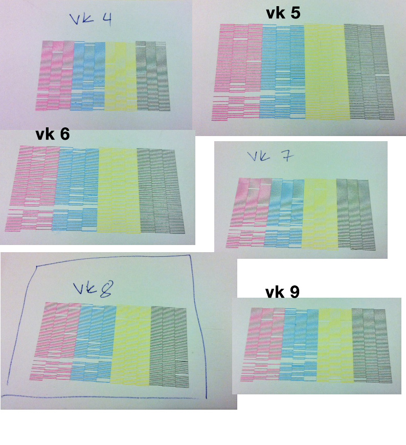

Second unit is have MAJOR issues. It is banding like crazy. I have been dealing with Mimaki and Tubelite - Mimaki could care less and Tubelite is doing there best to fix it. The issue is they are not very close to me so it takes them over a week to get a tech scheduled. We are going on about 5 weeks now with them coming down every week and a half to try and fix it. They end up leaving with NO results
Mimaki pretty much does not give a crap at all - Since day one we have had issues with this machine and now its gotten worse. When these machines work they are awesome - as soon as something goes wrong - you are ON YOUR OWN. I have 2 Roland XR4 wide format printers - if and when i have an issue... within 1 day MAX i have a tech out there fixing the problem. IF THERE is even an issue.
With these Mimaki's its a constant NEVER ENDING battle getting them running good. And keep in mind there are NO LOCAL TECH's. I don't know if I made the right choice and now I'm stuck - I'm down to one machine running the entire portion of the business. If that machine goes down - we are literally screwed.
I am attaching an image of the banding. They have come down and aligned the head, adjusted head angle - tons of test, they leave and end up not hearing form them for about another week or so.
They just left on Friday - i went to the office on Saturday did a test print and its back to banding. They claimed it was fixed - shut the machine off - turned it back on and the issue is right back.
If anyone has any ideas I'm completely open - if i lose the second machine I'm literally out of business.

Are you running nice long nozzle washes and checking the print test patterns every day? Can you post one of your nozzle check patterns?
We run a 6042 and have fought the same fight to keep them from having nozzle drop out.
