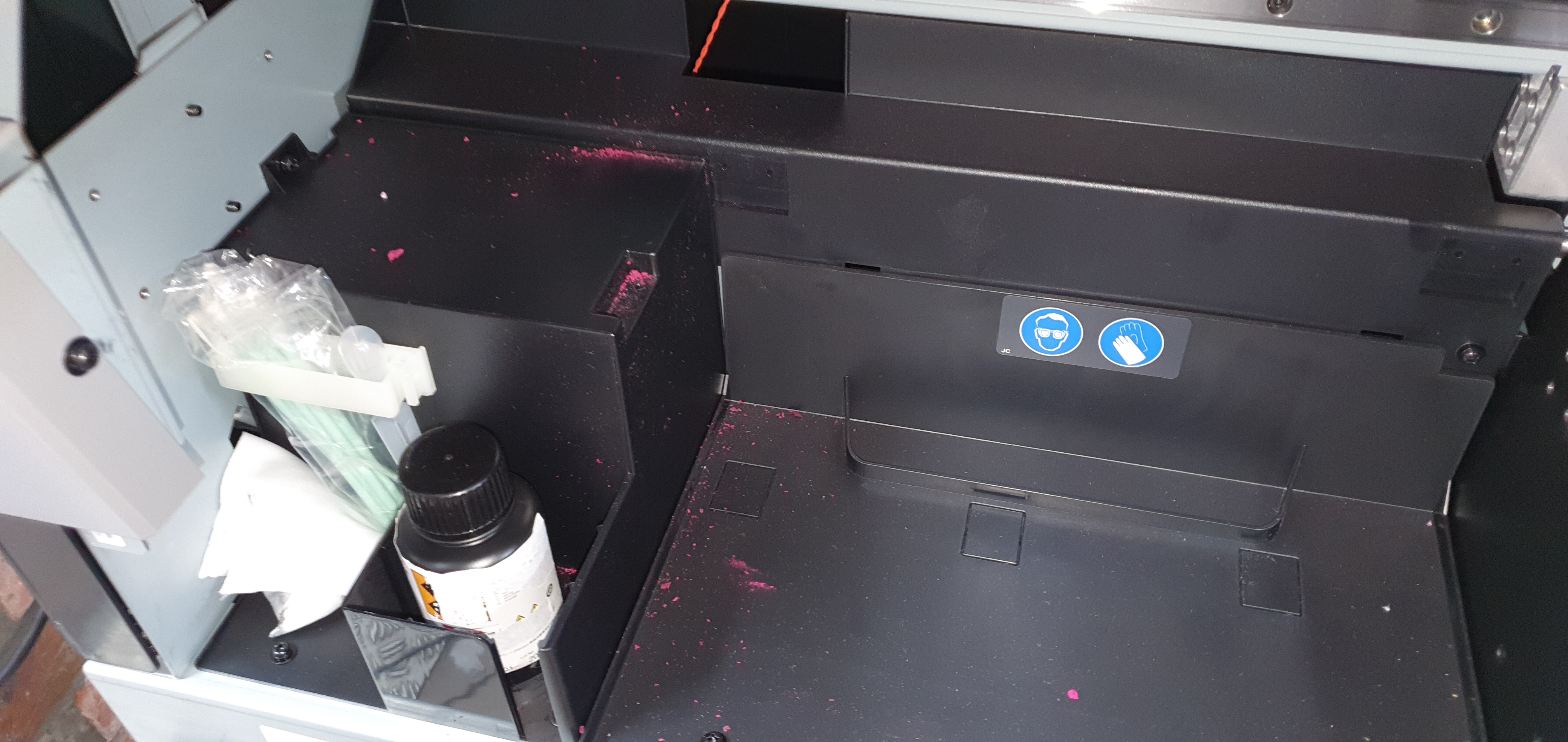

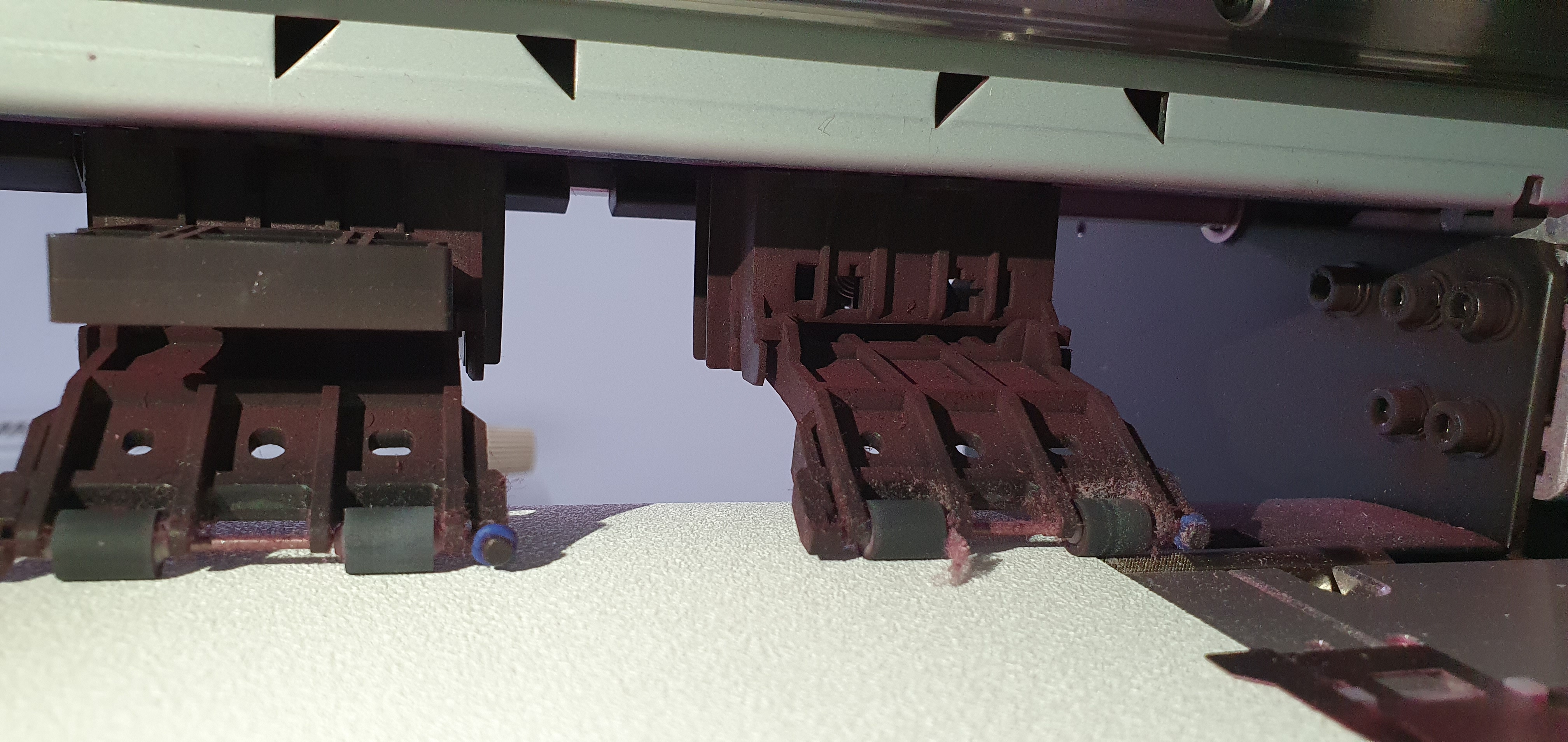

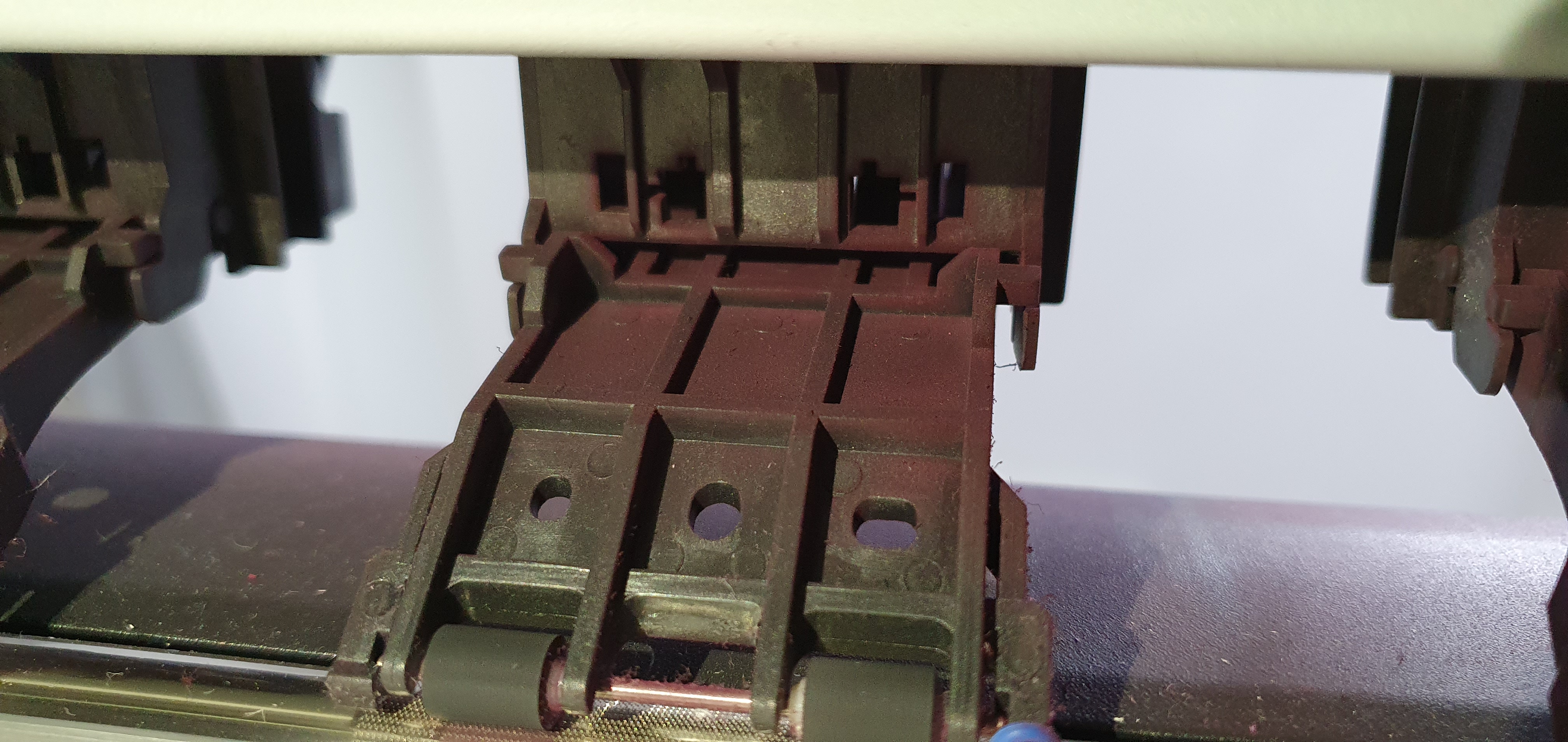

Good morning,
I also have a UJV100 since September 2021 and also noticed a problem with the magenta, it was very badly powdering all over the machine it turned out that there is already a new version 2 magenta needed to change the frimware to 6.0.1 after the change everything is laughing nicely.
Greetings
