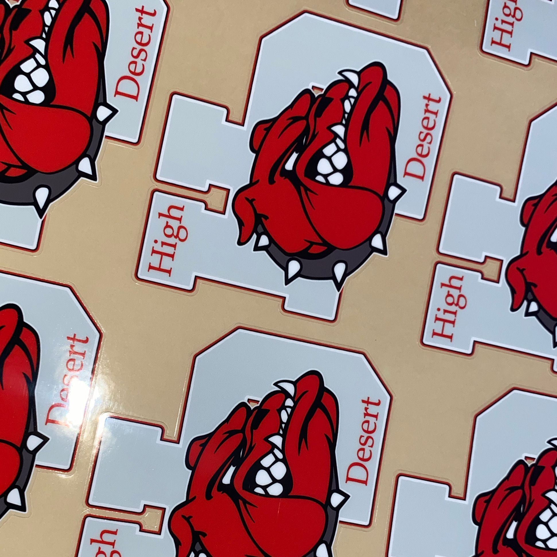

I finally got my 700w printer installed and the print quality with 100 underfloor white is awesome! The print speeds are slow though but I’m comparing them to my Gerber Edge FX. which is a pain in its own right since you need a manual operator to change colors out. May be faster but I don’t want to have to manually change colors out anymore lol
I could have printed this on white material but wanted to try the white on clear and provide a clear edge to the decal.
