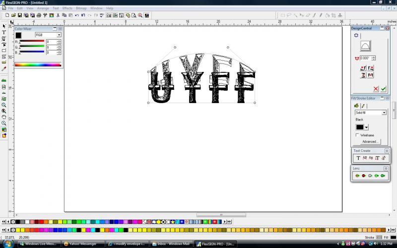

    An I missing something simple in flexi to shape text?

    no, no, they're asking if there is something equivalent to the corel's envelope tool in flexi.
    btw, I don't believe there is. Flexi will do text on paths put I haven't found anything it that will envelope text into various shapes. If you have corel, do it there and save as EPS for flexi.

    Use the Distort under Effects.
    .[​IMG]

    ahh yes, distort, THANKS! I knew it had to be there somewhere :)
