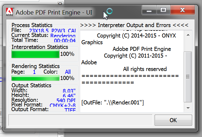

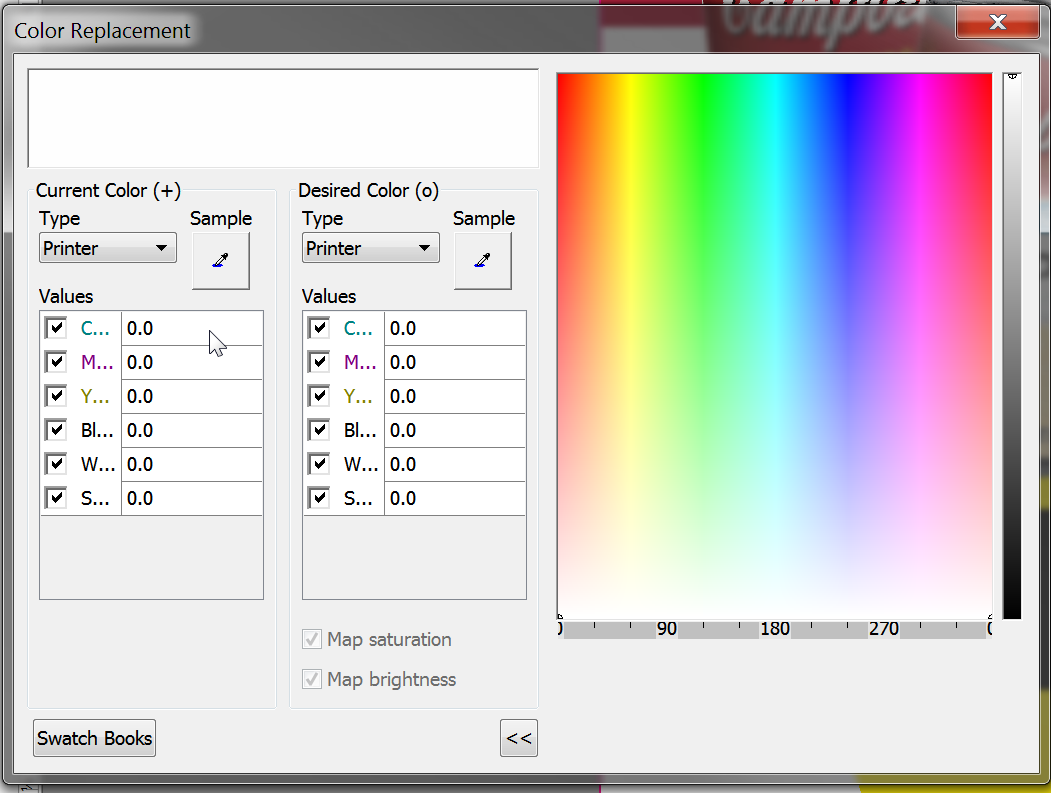

    I wouldn't go 4K either. Onyx doesn't have scaling support. I'm running windows 7 so if your running windows 10 it might work better.
    Also, I have yet to get job editor to display the correct colors even when the monitor is calibrated. Outside of job editor it looks fine.
    I'm probably missing something though.
