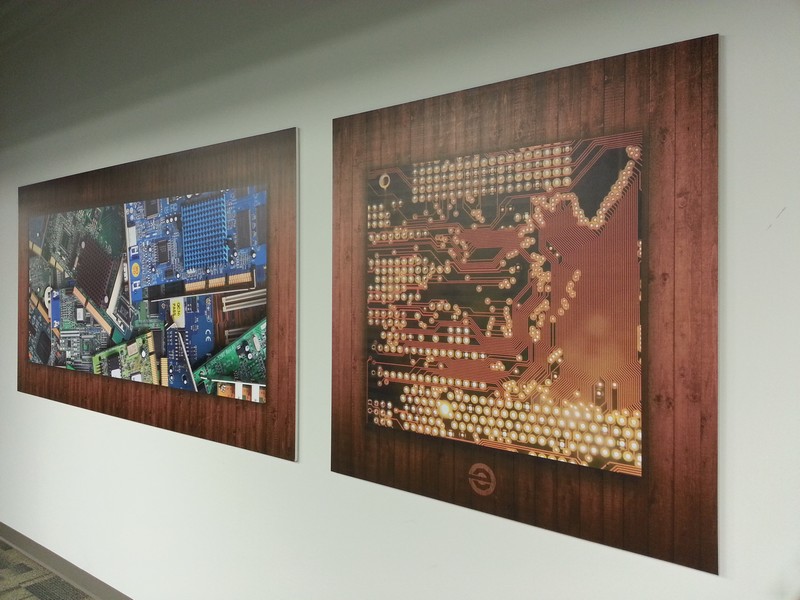

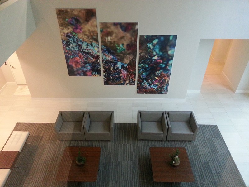

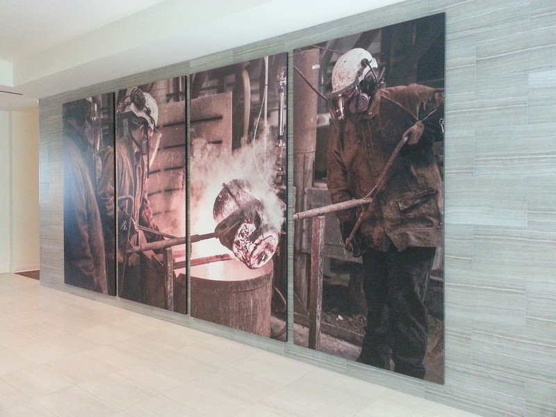

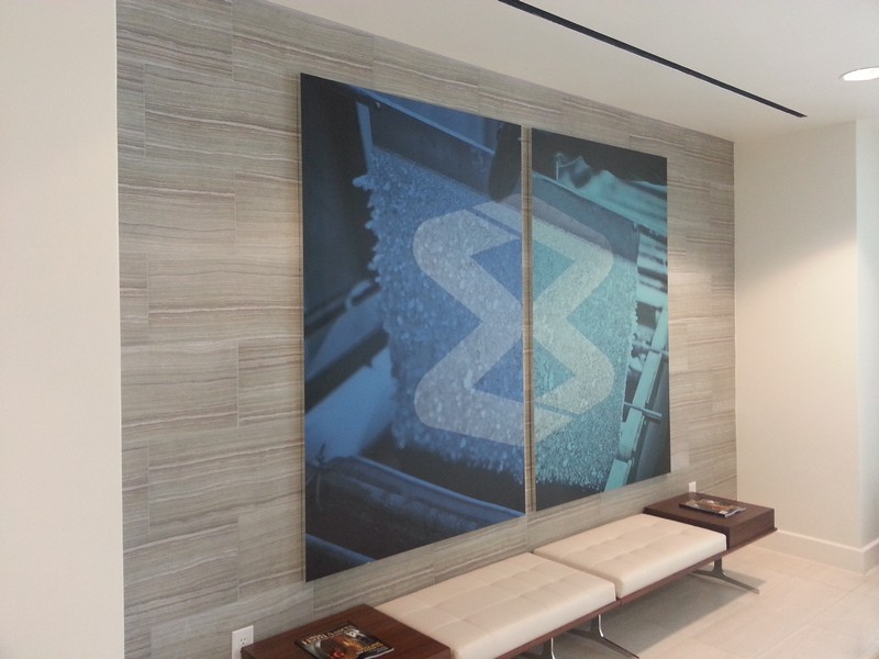

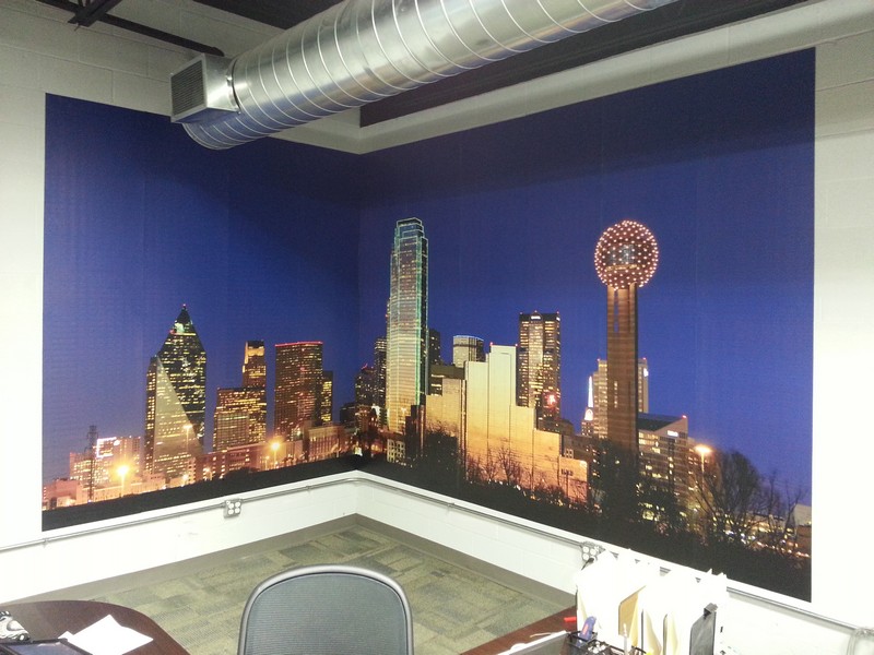

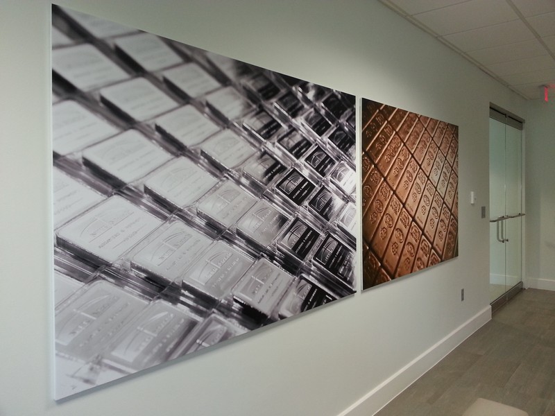

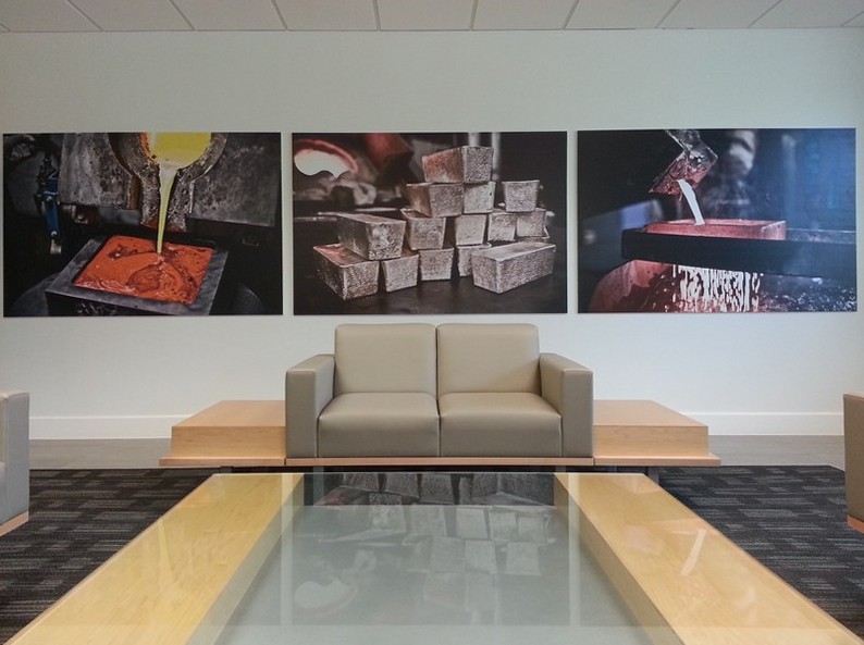

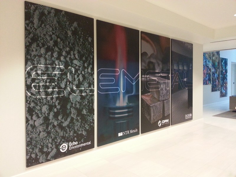

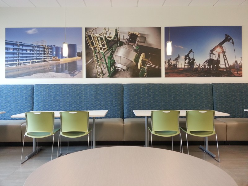

The panels below are Gatorfoam and Sintra mix. They're all hung with Command Strips.

The Command Strips aren't suggested for use on wallpaper.
If the customer doesn't mind damaged wallpaper, I would use 1" squares of VHB tape (add a few dollops of silicone if they really don't mind damage). If they want minimal damage, it depends on what material you're hanging, but I guess at that point, you would have to use a mechanical fastener. With thicker panels you can get creative and epoxy keyhole hangers on the back. Which now that I say that is how some of the previous pictures I posted were hung. Forgot about that. :covereyes:
