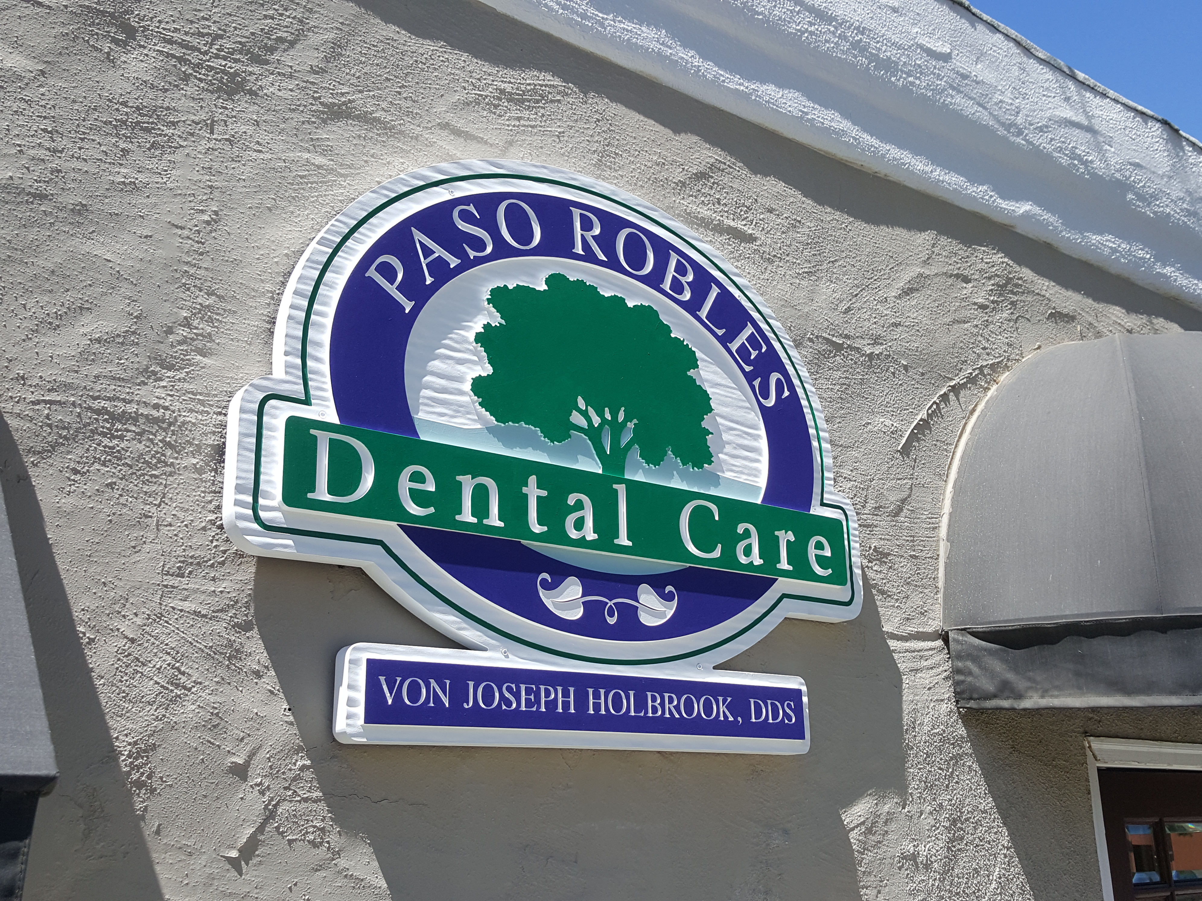

I wouldn't use MDO as a backer on the size sign you asked about, but the one in the photo is about 3'x4' and we used it for that. I wanted to make sure that bottom portion had some good backing to it.
I understand the concern about expansion/contraction but the materials are probably pretty similar in that department and we're in a location that gets only 15-20 inches of rain in a good year. As with anything, we try to match things on an individual basis. We're mainly doing it for added rigidity and to give us something better to grab our installation bolts, screws, etc..

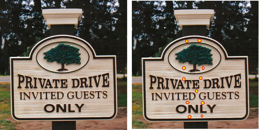

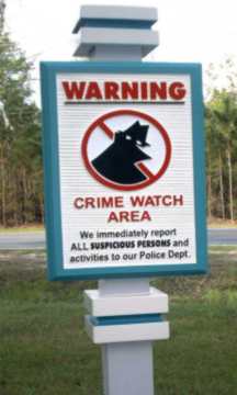

I have done bunches and bunches of just this type of signage.
I put many stainless large head screws right through the face
of the sign, cover with exterior latex caulk, and touch up the paint.
and hope for the best. if someone wants it, they will get it. period.
I have never had one broken from regular, non-abusive use.
