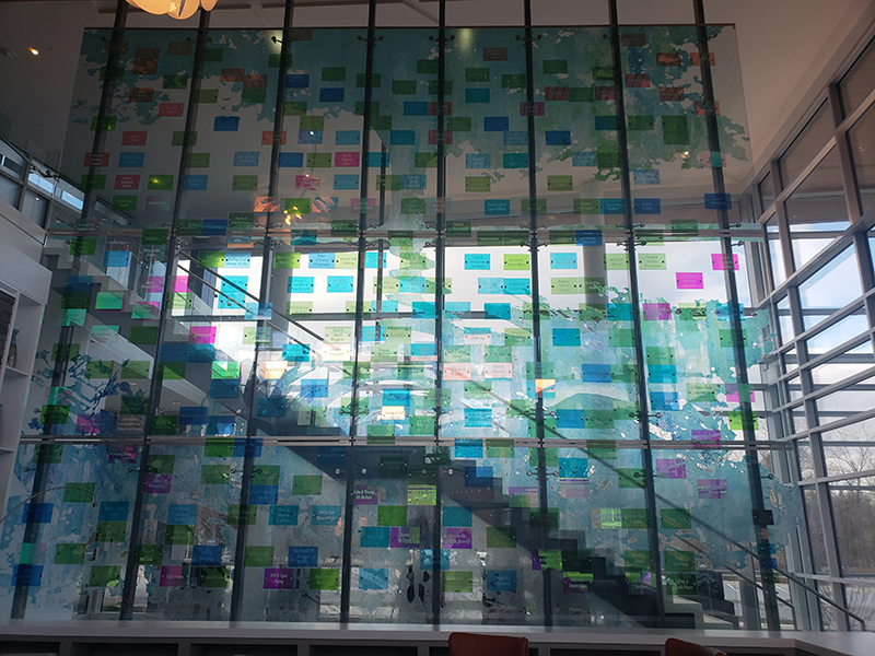

Our client has a very large window with colored glass plaques that are mounted to it using these "glued" or "adhesive" standoffs. The whole thing looks like a giant stained glass window.

Here's the current wall...

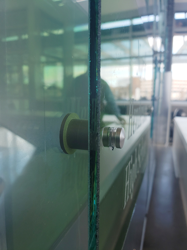

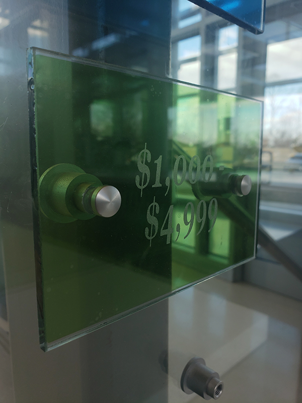

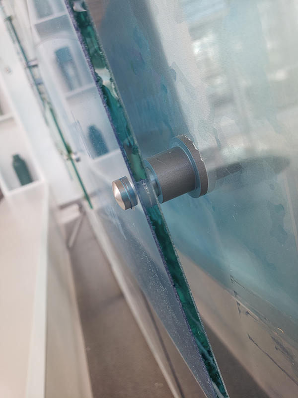

This is the standoff. Doesn't it look like there's a half-inch aluminum standoff (the hole in the glass is 3/8) inside the "top hat" that is glued or adhered to the glass?
That's why I'm assuming this is a 2-piece set up.

It looks like the standoffs holding the small signs are ordinary standoffs, available from lots of vendors. However they appear to be attached to a larger device which is stuck to the base glass, which has the picture of a tree on it. Is that correct?
I didn't find one in a quick perusal of their website, but CR Laurence makes glass standoff and attachment systems that use a UV cured adhesive. You might give them a call. http://www.crlaurence.com/

I haven't seen a standoff like that before. Is it metal or plastic? Almost looks like they mated a regular standoff to a custom barrel/base
