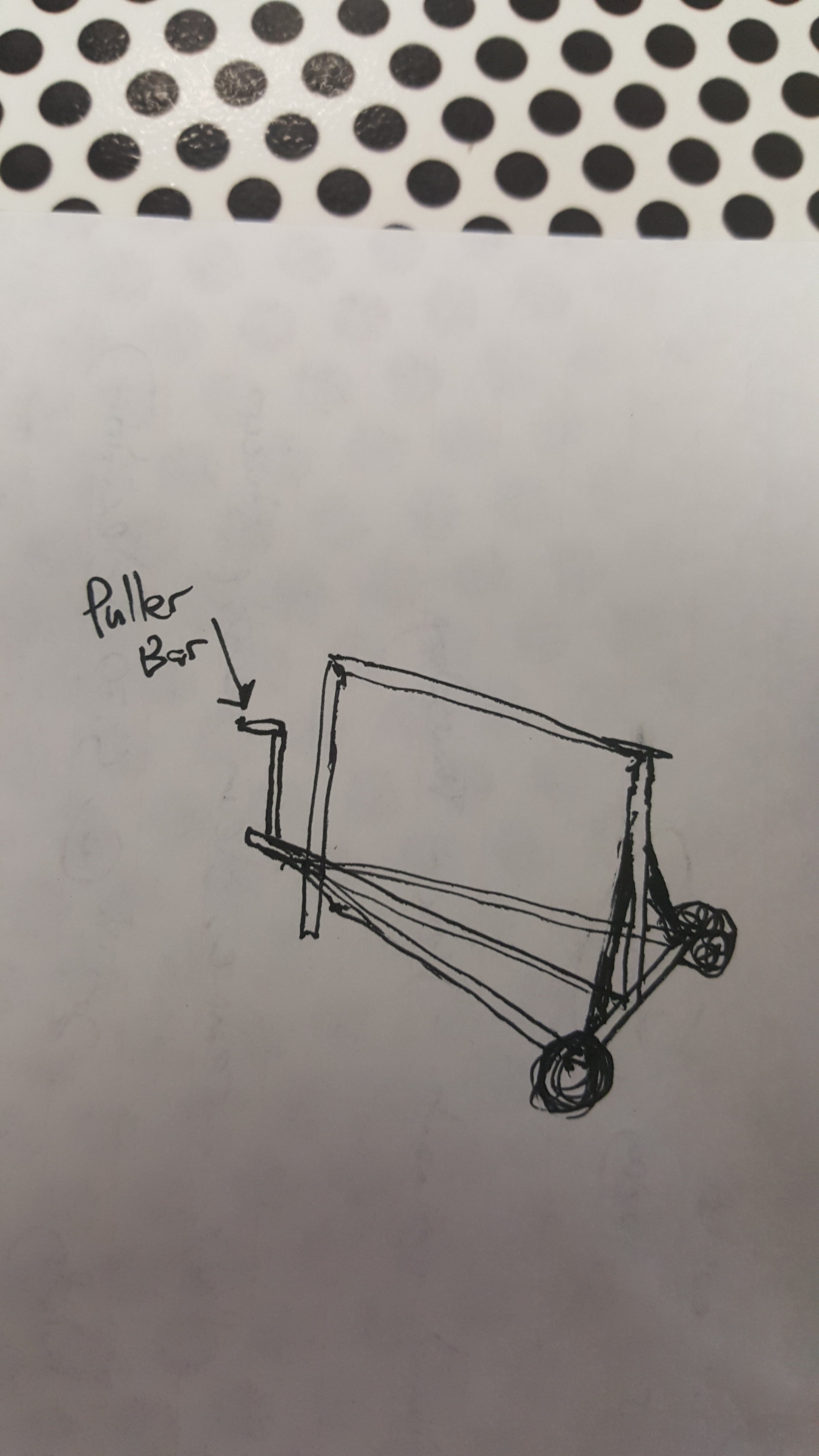

Customer is looking for a movable wooden sign. It should accommodate a 36" tall x 48" wide panel, OR 2x 36" tall x 48" wide panels in a V-configuration.
Any ideas for structure? This is a rough drawing I did for what I think will work, but seeing if someone has a prettier option.

Once you get your framework, wood panels and trailer all put together, do you really think someone is gonna be able to pull it with that little handle ?? Also, what's gonna keep if it from blowing over ??

Those are really small signs. Do they really need to haul them around or are they wanting to have something they can put out when they want to and move it out of the way when they don't? Seems like a A-frame might work better for that rather than a complex heavy custom built wagon.

It's for a school - they are only going to be there for a year, and don't want to permit anything. They're also zoned residential and can't have permanent signage. They have had a plastic roll-out sign of a type ive never seen before - it has two inverted and stylized "T" shapes, with a 1/8" threaded rod connecting the sign area, which runs through coroplast panels. The base is plastic as well and connects the the inverted T's. It's all sunrotted, cracked, and falling apart.
It's a 25mph road, so 36" x 48" should work fine for them.
They do want to put it out daily and take in at night.
Just wondering if anyone has another option before I draw this one out.

It would probably be better and faster to make it out of steel. Rectangle bottom, square tube uprights on each end sort of like your picture capped with angle to mount the top of the sign and another angle (angle edge up to match top) across each bottom side to attach the bottom of the sign. Id also make a provision to attach this contraption to some auger style ground anchors so it doesn't hurt someone in a bad wind.
The angle on the top in the center may make it lay back to much, that you would have to toy with.
