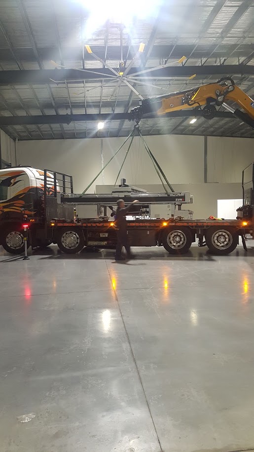

Do not lift it with a forklift. You need to use the lifting points, slings/chains. You also want to back off the screws that level the bed. Then when back in place relevel the bed.
Our zund is a 2XL G3. It was wider than the bed of the truck. We welded steel supports that we placed on the truck and the zund sat on these. I can get a photo of them if you need.
Photo attached of how it's lifted.

We had a tech take ours apart and reinstall. physically wouldn't fit through the rollup door at either location. Like everyone else has mentioned, you'll want to re-level your table after a move. If you have a smaller table, our tech said it could be moved in one piece but there are still some steps to prep it for transport. Give them a call, the techs can guide you through it.
