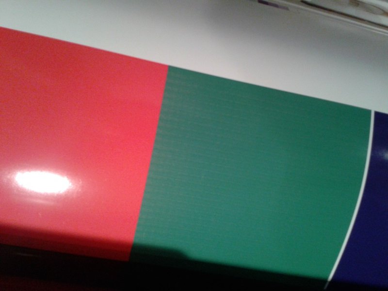

Has anyone seen this issue before. Color drop out.
It cropped up about a week ago, I cleaned both the T-Fence and Encoder Disk ( they were filthy ) and also adjusted PF and it took care of it atleast I thought it did.. I ran well over 150 yards yards since then no issues...
it's fairly consistent, nozzle test is ok ( I have been missing some nozzles but not enough for it to effect print quality to this extent )
I also ran cmyk/rgb block test and only the green has issues,
I am perplexed.
Any ideas

I would wet the cap top with some cleaning solution to see if that helps it seal better before I do a cleaning. Also, judging by the green square in the picture above, it looks like your manifold may be partially clogged. I have seen that exact problem happen a couple of times and I ended up just taking the manifold off the head and flushing it with cleaning solution. Do you see how it is dropping out cyan on the right side and gets better as it goes left? That is from the ink not flowing strongly enough to the head to get a good start from the clog in the manifold. If you are not comfortable flushing the manifold, I would get a tech for sure.
