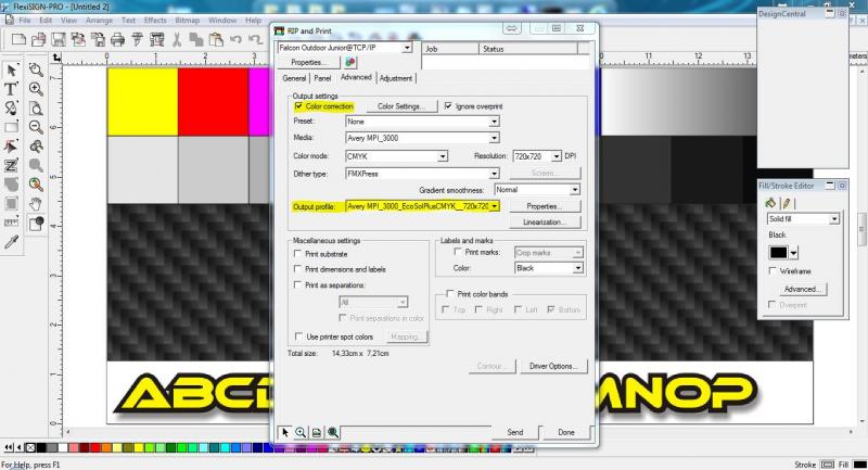

Now my next issue is the pic i want to print prints darker than what it appears on the screen... Any help with this..???

Good to hear one problem solved. For the darker problem did you tried other profiles or a custom profile that is matched to the monitor?

the software is Aurora rapture..... it printed first 2 times exactly as the monitor looked... as far as i know i havent changed anything....
and i dont know how to load profiles as for certain pics or software... all the other lettering i put on top of the aurora looks perfect...
CRD
Sorry I overlooked you are using Flexi.
In Flexi you set your profiles for color correction.
If you hit the rip button you get a screen with 4 tabs.
From my head one of them (advanced) you can set the resolution and also set the specific profile and material you use.
I asume Aurora is a design program for carwraps and then the final file will be send (as whatever FLexi eats liek .BMP) to be ripped and printed by flexi.
Am I correct or wrong?
Paco
CRD
This is what I mean.
