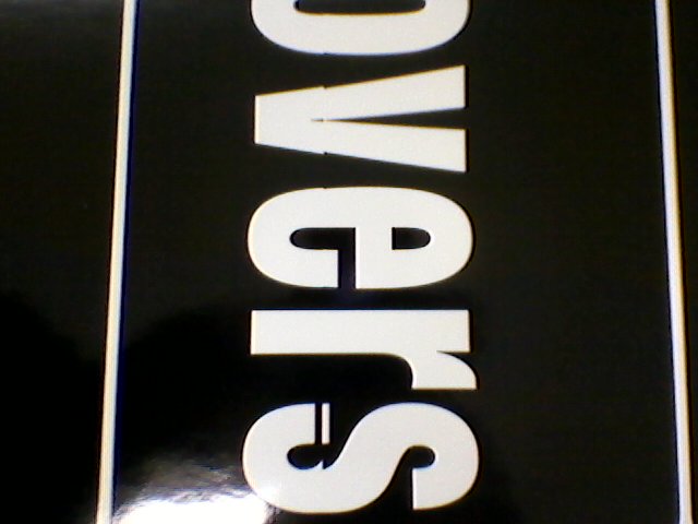

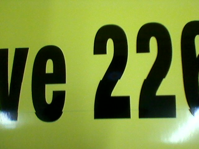

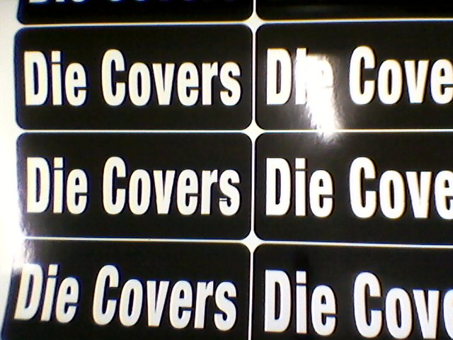

I have a Mutoh 1204 that's been running solid for 5+ years. I did replace the maintanence station in 08' but that's it.
This is the first experience I've ever had with printing this way. The strangest part is it's not consistent in time, distance, color or even the amount it's staggering the print. There is generally a smaller thin line out the side and across the media (horizontally) where it's doing it.
Take a look at the pics, any advice would be greatly appreciated!

tsgstl
It's definitely a communication problem. It's repeating and subtracting parts.
Never seen it before, hopefully someone else has. I almost think its a buffering or ripping problem.

Problem solved! It seems so obvious now (like always)
I had a bad ethernet port on my new comp that causing all the miscommunication.
FIXED
