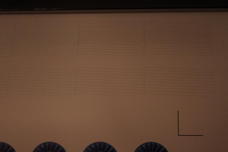

PolarBear
I'm sorry it's not a better picture, but I wanted to get something posted. I'll try for another image in a few minutes, but I was having difficulties with my camera this morning.
Here is the black and half of the blue nozzle check. (the bottom one since the top 2 overlapped)
Lori

Tel
Not really what you wish to hear but when we had inks mixing like you describe on a 1204 it was the manifold in the head, the plastic/composite type material that the dampers fit into apparently with lots of use it cracks and the inks can cross contaminate, unfortunatley the fix was a new head.
I hope I am wrong in your case.
Good Luck
Tel
