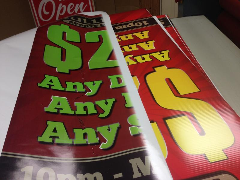

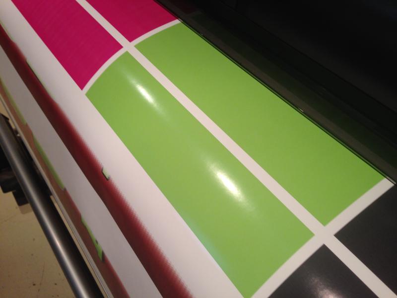

Ok so today I fired the printer up to get some work done. As I do daily I give it a quick once over and clean the wiper etc. Fired off a print and it was all real real dark. Ran a STRONG clean 2 times and then ran a nozzle check. Nozzle check for all 4 colors except cyan came out black. Then I noticed the lines where all black going into the print head. I've never had this happen ever so i was kinda lost. Started checking to make sure I didn't mix up and ink cause I did replace magenta right after the machine fired up. All looked good there so I decided to just do a full headwash. Went thru that and it fixed everything except for the yellow is now coming out a shade of green. Ran some more STRONG cleans and even ran some blocks of just yellow to see if I could get it to clear up and nothing. Lines going into the print head for yellow look green to. Looking for some HELP!!!

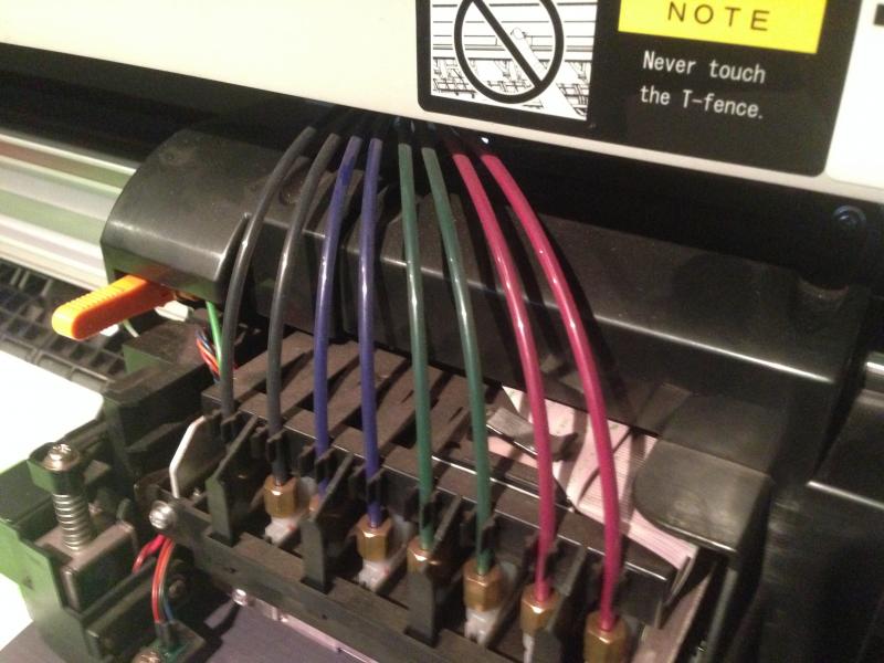

From the pink and pastel colors on the feed tubes going into the dampers it is pretty obvious that your 1304 has embraced an alternative lifestyle.

Have a look at the pipework going over the top of the carriage, how far does it go back?
Maybe a good idea seeing you have the cover off (and also to save a lot of the other ink!) is to pull the two yellow dampers off and then pull the yellow back with a syringe then reattach and do a few heavy cleans.
Then you should have cleaned the contamination.
I would install a new capping station as a matter of course and check all the lines are clear and the pump is working properly.

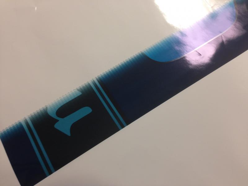

Wonder if this might be the issue? i checked the entire line and the green color went all the way back to where the cartridge snapped in. i decided to cut it open and found this.
