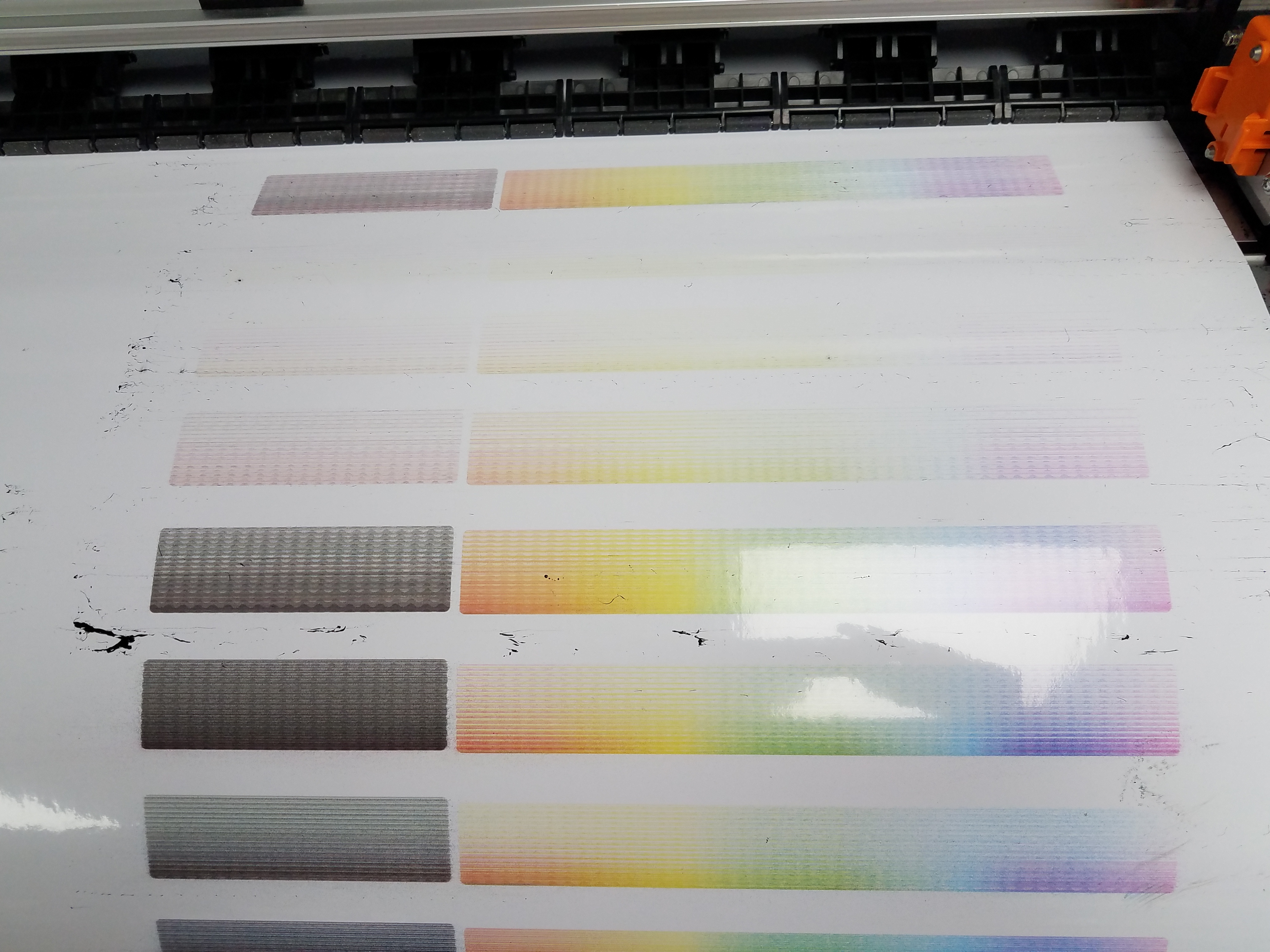

So printer was working great all day yesterday and then all of a sudden not firing on all nozzels
Have done many many head cleans and after each one I get some printing but it goes bad on the next print.

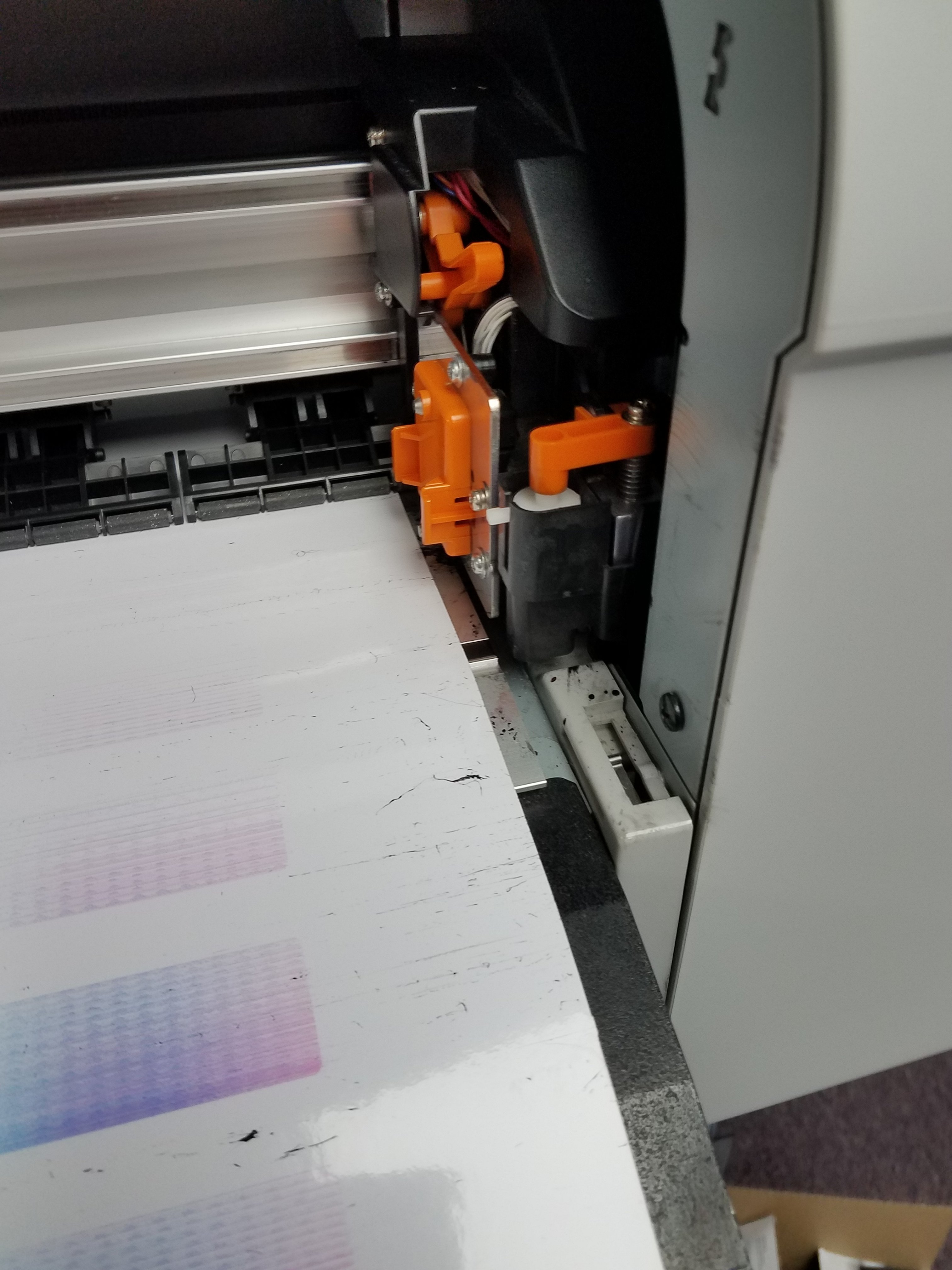

There us a horrible clicking/grinding/jerking when printing and I can't tell if it is catching somwhere
My thoughts
1. Capping head just crapped out
2. Head is not going all the way back to station
3. No idea on the jerking/grinding noise
Any ideas????
Photo of print and head placement finish attached. Video for sound of catching
Thanks

That sound isn't normal for sure. You need to unplug the printer and then move the head manually back and forth to figure out where it is catching. You should be able to feel it when it catches. Once you can figure out where that sound is coming from, it will lead you to the solution. You might have to take some covers off to find the source of the sound.
chrisphilipps
Merchant Member
It sounds to me like something to do with the CR belt. I have seen 13xx printers do this. If you remove the cover on the right hand side of the printer you will see the tension adjustment for the belt "jump" every time the carriage changes direction.
unmateria
For the timming, Sounds like tensión belt spring is very soft or cutter is down. You need to remove covers and check where the noise is.
