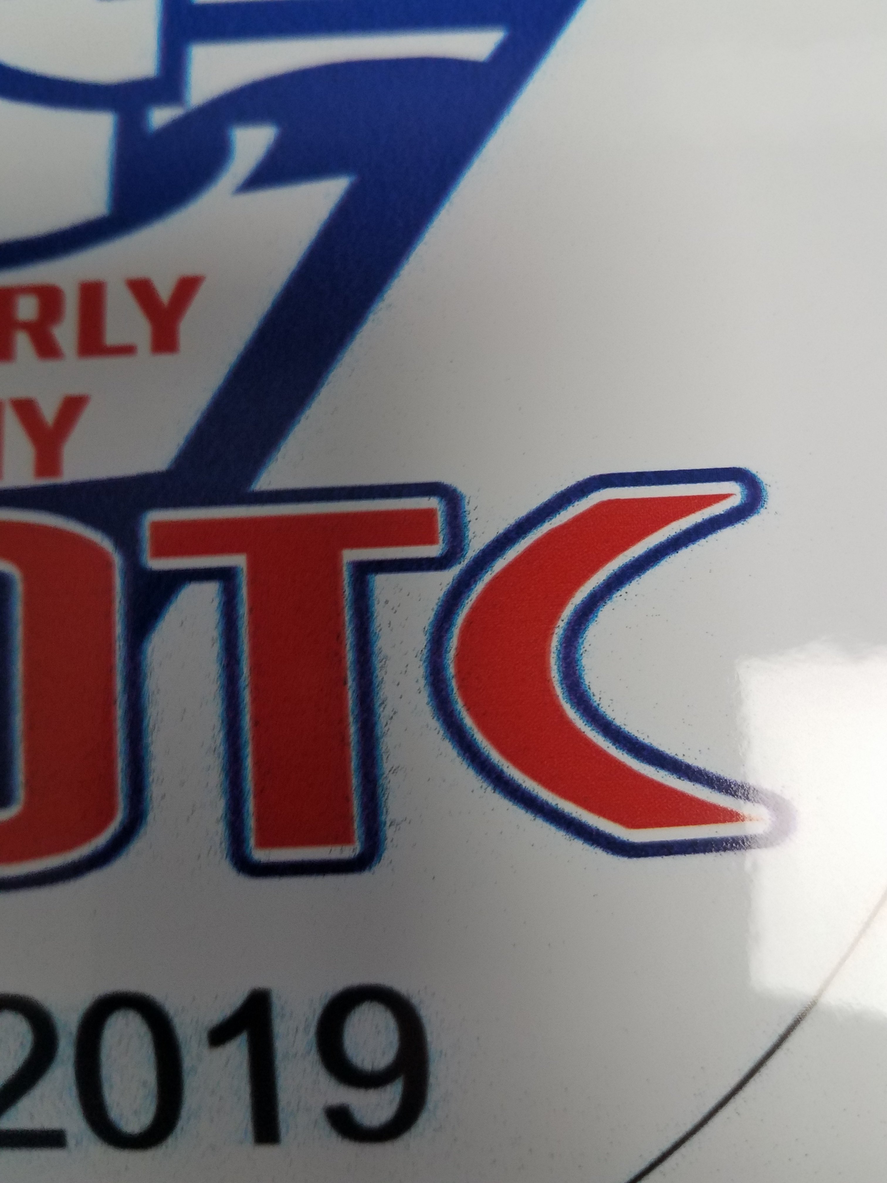

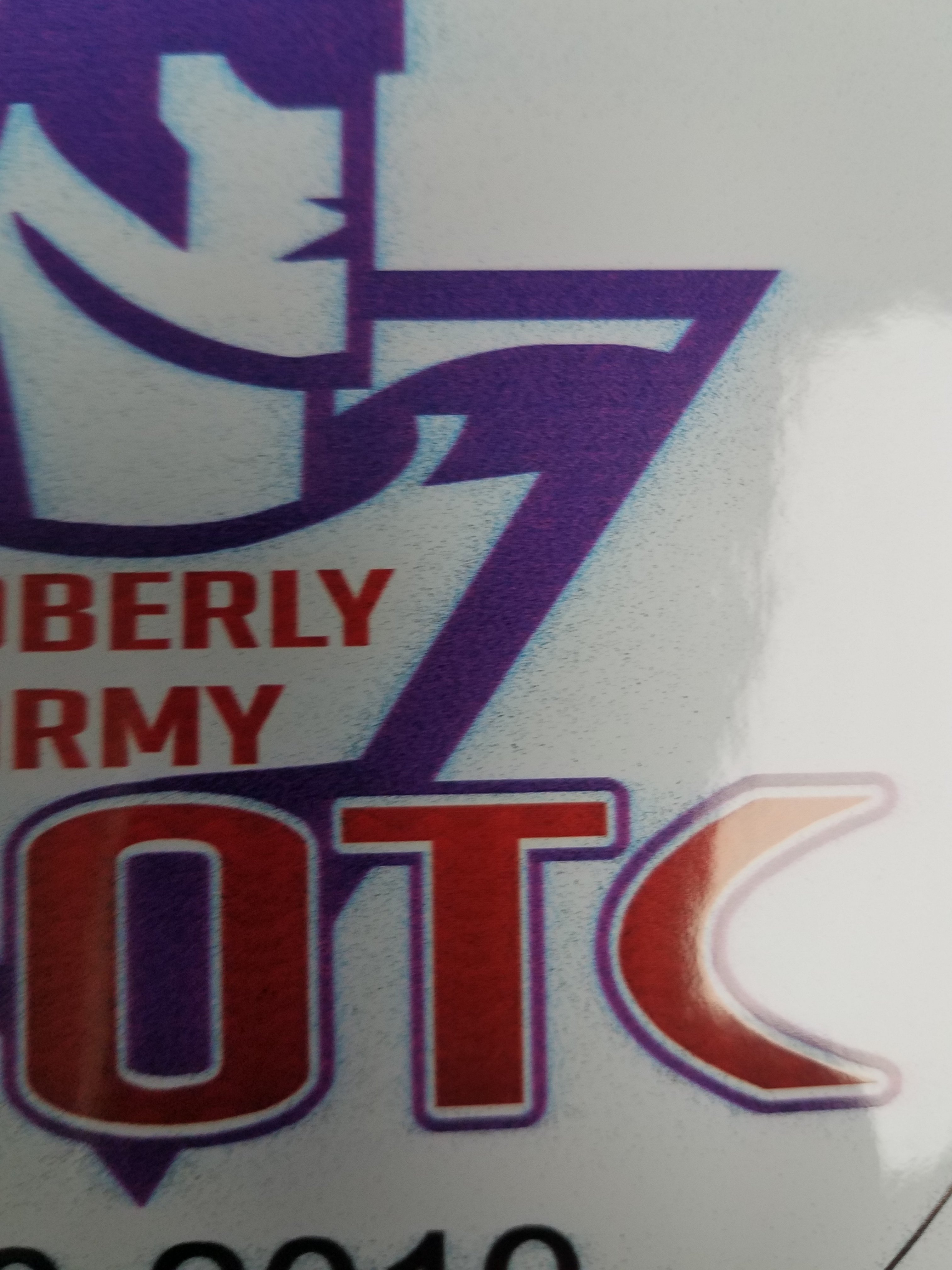

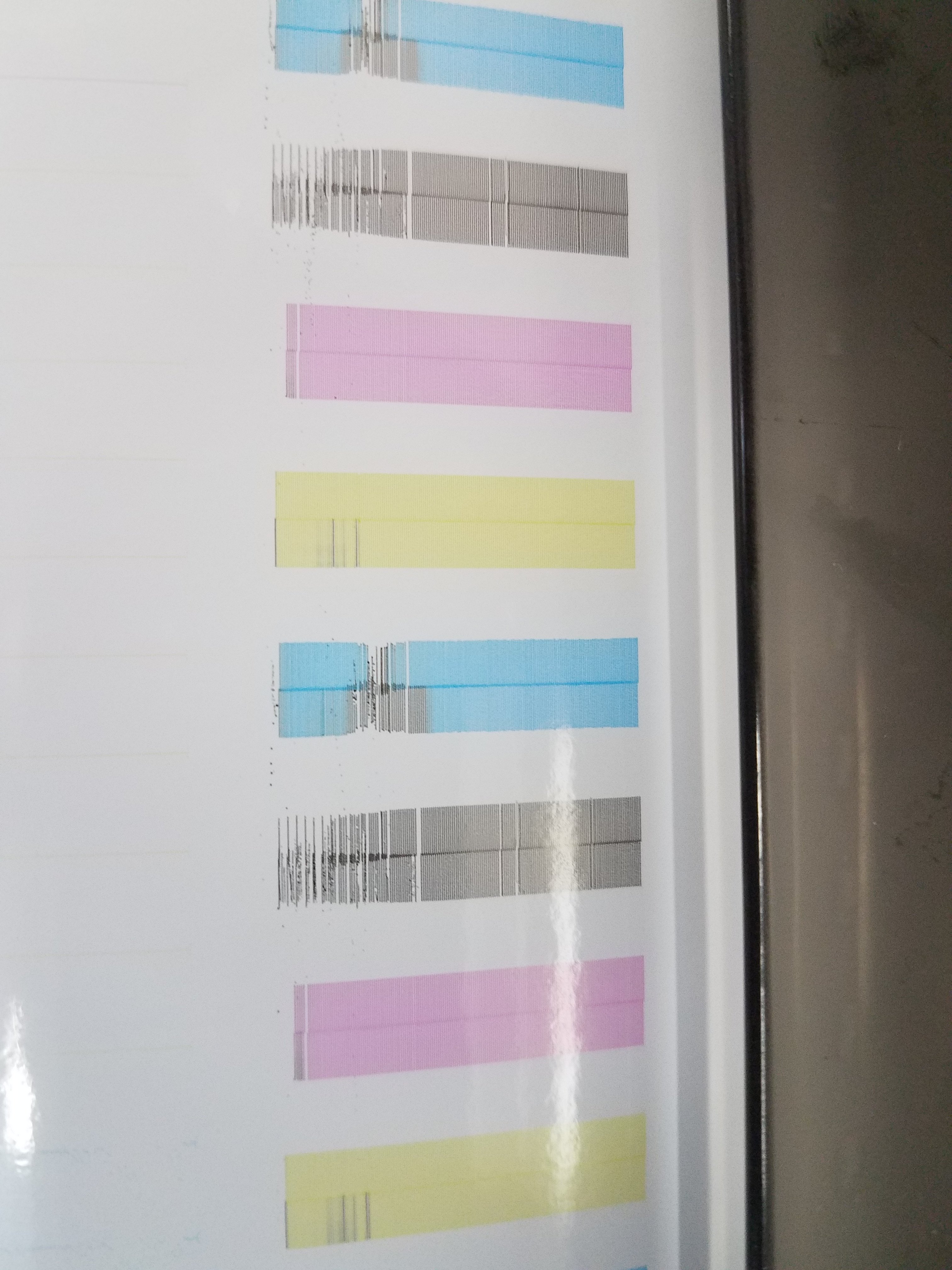

So I have replaced the maintenance station and still having some issues
If you look at the photos below I am having most issues with blues and this changes on the type of blue I use
Some banding is also occurring as well as the spatter/shadow effect
Any ideas?
1. Encoder?
2. Dampers
Head alignment - could someone help me through this? I have the manual but not exactly sure what I am looking for

Looks like your head is done for. That much over spray in the cyan is almost certainly an electrical failure. You also have cross contamination going on which could be internal damage to the head or a failing maintenance station.
jriley
Send the head over to the left side of the printer and inspect the bottom of the print head. Use a mirror and a flashlight if you need to. Looks like there's some major nozzle deflection and cross contamination going on. Have any head strikes before this problem started happening?
As far as the cross contamination goes (black in your Cyan and Magenta channels), this should have been taken care of by the replacement of your maintenance station and a Long Cleaning. Have you run a Long Cleaning since you swapped out the maintenance station?
Also, can you attach a picture of your nozzle check in end user mode?

That is oversprying. Usually solves with heavy cleaning and sucking solvent from the dampers pins (check if dirty is going out, and use a different clean srynge to injto inject soft solvent). If after that doesnt work, yes, is the way Many heads dye after heavy use
