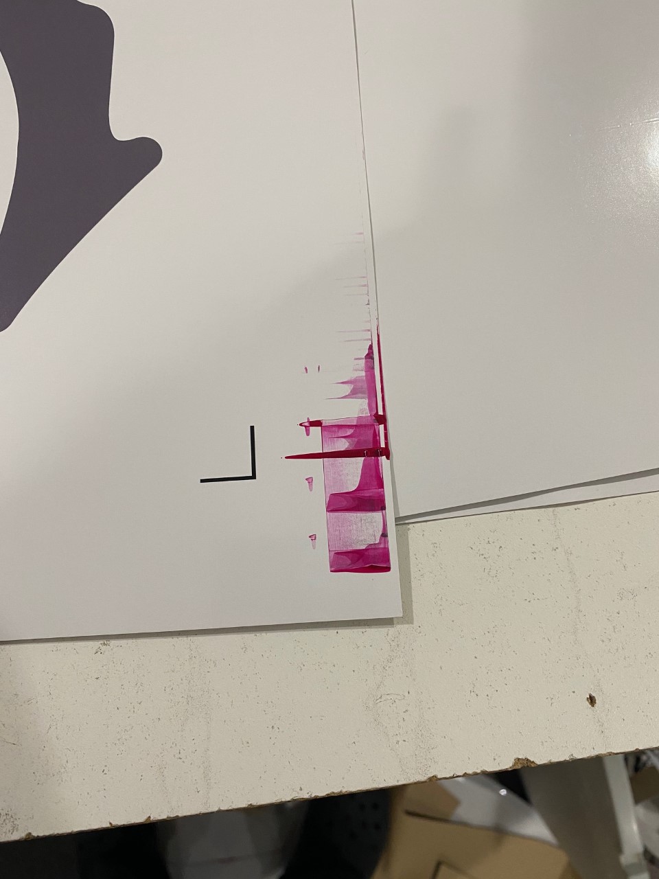

Just recently my 1324X has started leaving Magenta streaks on the edges of the material. I've tried cleaning the ramps but that didn't seem to help much if at all.

Looks like magenta is dropping out of the head. Usually that's going to be a bad damper. If you haven't changed then in the last 12 to 18 months, I'd start there. Also just make sure the bottom of the head is clean, the wiper is make good contact with the head surface, and the cap top is draining properly.
