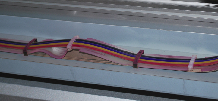

Sometimes when I'm printing the machine sounds like the carriage is slightly hitting the pinch rollers and makes a fast dragging or rubbing noise. This doesn't happen a lot, and goes away somewhat quickly when it starts, but I can't stand it. Anyone else have this happen?

jiarby
Take the top cover off and watch it print a couple rows.. you may see the inkline strap bunching up and then un-bunching... it sounds very clunky like it is hitting something.
