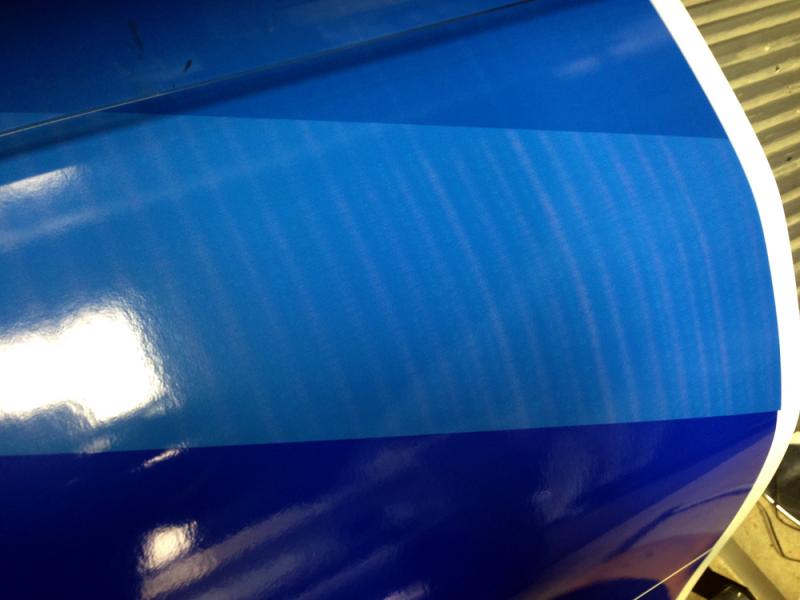

Mutoh 1614 horizontal banding. ONLY with baby blue

Before warranty went out about 6 months ago I had a Mutoh tech come in and work on this for a full day and got it a little better but now it is progressing to crap again.
Only on baby blue. Only on the right side of the printer closest to the head parking zone. About the first 1/3 of the bed.
Tech put in a new head, pf wheel and that plastic encoder strip. It just seems to me like it is starving for ink but....
Does on all materials and also at any platten and pre heater temps.
I am gonna smash this printer. 4 years old. Also changed the dampers 6 months ago.
Help!
That looks to be vertical banding (in the direction of media travel) not horizontal banding (carriage travel direction). If it is only on one side of the machine, I would first suspect that the media is not feeding properly through the machine. Possibly the transport wheels are differently wearing on that side? Does the banding coincide with any physical feature of the machine (lines up with pinch roller wheels or platen towers etc)?

Yes I meant VERTICAL banding. It's been a LONG day
It is vertical banding. It only does it on light blues. No other colors. It does not line up with the rollers at all. I am turning the heat settings down to 36, 36, 50 and see if that helps too.

h82loose
