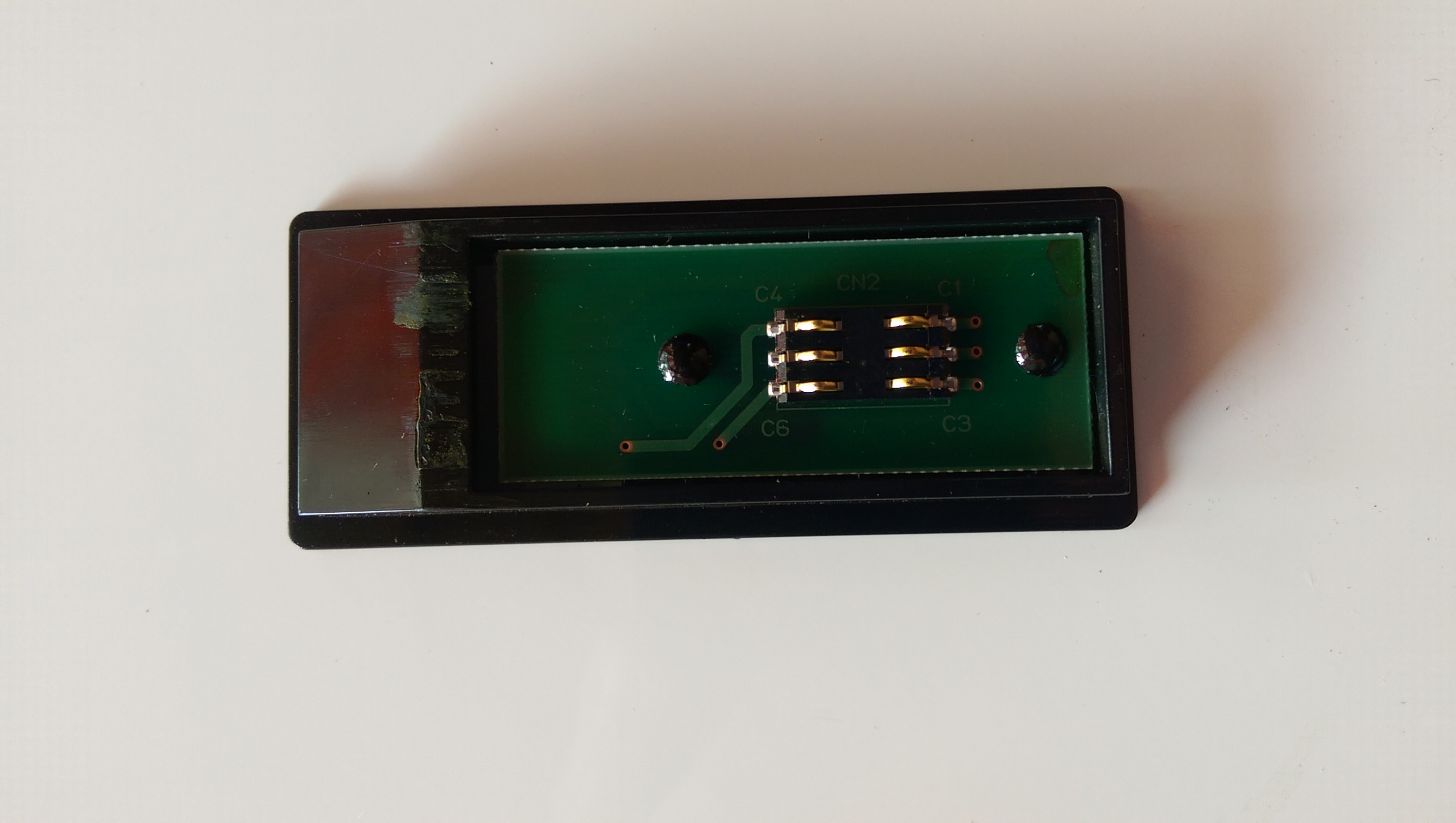

What do the ink end sensors look like? are they in the carts?
I replaced these where they slot in but with the same issue
Umca
Ink End sensor located under your part what on photo. It looks like short black arm with micro-switch. Usualy with bulk system that part is broken because cheap bulk cartridges bigger a little than original.
If it broken, it tells to the printer ink is near end. So, the printer reduce ink volume on cartridge to 5% even if it new. And, it will end soon.
