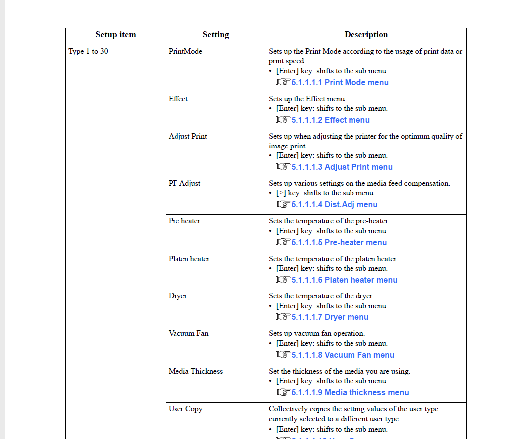

Hello Henry can you tell me how to set the vacuum settings to high please. I tried looking for it under setup with no luck. Thanks in advance!
henryp
The vacuum setting is on the Media Type sub menu. With this printer model, you can have to 30 (?) Media Types and you can have different values for all of these sub menus, the printer will remember the settings so all you have to do is select the corresponding Media Type to the media loaded on the printer.
