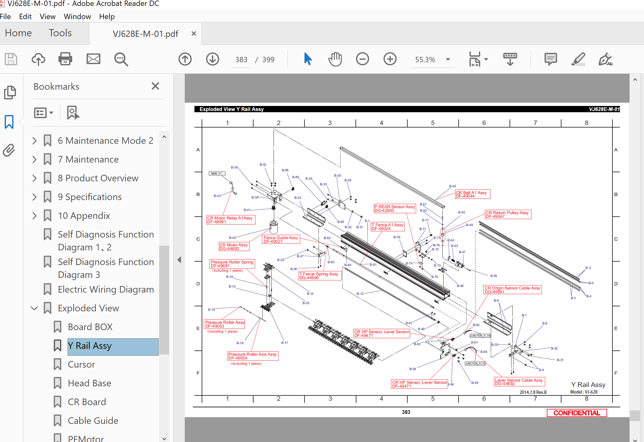

"No Media" error possibly due to faulty rear media or lever sensor. Try the following troubleshooting procedure. Switch off the printer, remove the media then power back on. Check the printer status on VSM, then load media and turn the orange knob to bring down the pressure rollers. If you still get the same error, the rear media sensor is not sensing that media is loaded or the printer is not sensing that the pressure rollers are down.
