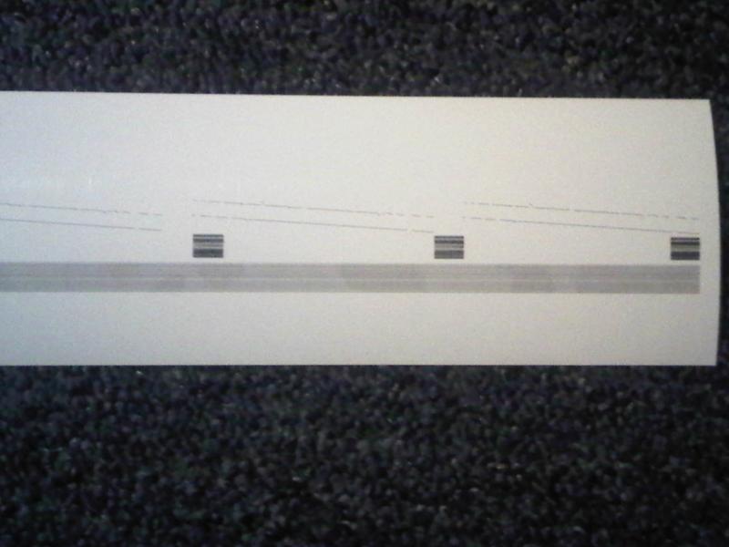

So far i did the flush and refill and i did get only the black dumper half full and the color dumpers there was no ink at all. Then i manually pull the ink to the dumpers until half full and after that i did few cleaning cycles and did test print. When test print i got only the black to print but no colors at all. When i was pulling ink from the waste bottle lines i could hear air between the capping station and the heads so for sure there is no good seal between them. Also when i was pulling ink i could get only cyan. But even if there is no seal between them should i still get the color head to print.
tomence
Here is a pic of the test print.

no seal means air is getting into the heads - prob clogged fairly bad...new capping station, head soak (overnight) then a few powerful cleanings...

Ok i did that and there was a good seal no air leak but i was able to pull only cyan. So i guess new head and new capping station. I have to check the fuses just in case to make sure they are not blown.
