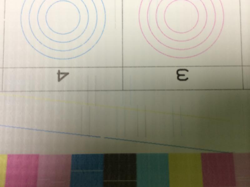

I know there are threads on this but its not that cut and dry.
I have a parts machine with low mileage and Im running out of parts to swop.
We have had an issue on and off with the heads firing when their not supposed to (see pic) and it was addressed in a previous thread.
The advice was to replace the Encoder Strip and or sensor. I swapped the sensor to no avail and then bought and installed a new encoder strip.
Voila!! it worked... for a while. The owner was checking a banner running after hours and noticed the marks again. While it was running he wiped the encoder strip thinking there was something on it.
The poster finished printing printing, cleaned, then went full left quickly hitting the left side of the plotter hard enough to break the mounting for the cutter solenoid.
Since then it initializes to the point of finding "Home" then goes full right and errors out. Y072 ERR Y Timeout.
After the head goes to the right (after sensing the home flag) it hugs the right wall then seems to go powerless and goes slightly left (cables and ink line tension) its then that it errors out.
The advice was to replace the Encoder Strip and or sensor. I swapped the sensor to no avail and then bought and installed a new encoder strip.Voila!! it worked... for a while. The owner was checking a banner running after hours and noticed the marks again. While it was running he wiped the encoder strip thinking there was something on it.
