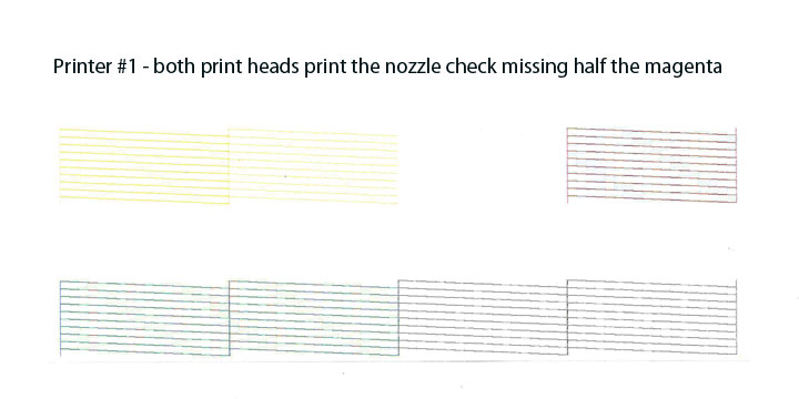

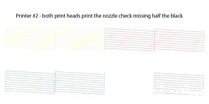

We have two Mutoh RJ-900’s. Printer #1 lost half of the magenta during a print job I thought it was a clog so I did everything I knew how to recover it nothing worked. Then we had a very similar problem with printer #2 this time half the black nozzles were not firing again I followed up as if it were a clog, but could not recover. I decided to switch the print heads between the two printers and the problems did not carry over. I do not believe there are any issues with the print heads both are fairly new. Printer #1 does not print half the magenta and printer #2 does not print half the black.
Could I have a problem with the firmware? Both printers are using the same version.
Coincidence that I have a similar problem with the motherboard on both printers?
Is this one of those end of life warnings that I manually have to reset?
If anyone has seen something like this before I would very much appreciate a little help

Hi Robert thanks for replying, Yes I have ink in all the dampers including the ones that are not firing. All the flat cables look good and are all clean. I do have ink in all the lines up to the head.
I did some more moving parts around between the two printers, I moved the main boards to see if the problems would move with them as a result I have one printer that works perfect and the other one a complete mess.
Printer one is now missing half the magenta and half the black I was only able to do one nozzle check the printer has now started to turn off after it prints one black bar of the nozzle check. I am also sometimes getting this error on startup “E067Err Xencoder”
