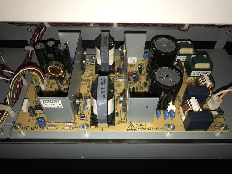

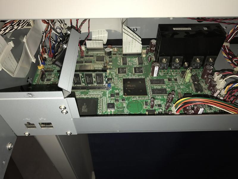

IMG_1141.jpg IMG_1142.jpg here are my boards ... cannot see any fuses besides one on yellow board but looks like its where power for machine comes in and out
Solventinkjet
DIY Printer Fixing Guide
thanks VanderJ for the response . i will check the fuse. any idea as to what fuse it is? any pictures on the web ? also if it was fuse would it give me an error or just remain doing as i posted
Usually you want to check the F2 and F3 fuse. It will be labeled on the board that way. It's very small, near the edge of the board near the black heat sinks that stick up from the board. The fuse being blown will not give an error. It just looks like it is printing and nothing comes out of the head.
villaprinting03
found fuses on board. f2 seems to look like it will pop out.... and f3 looks like it would need to be solderd , it looks to be round and black . thank for advice . i will check and get back to you , thank in advance!
