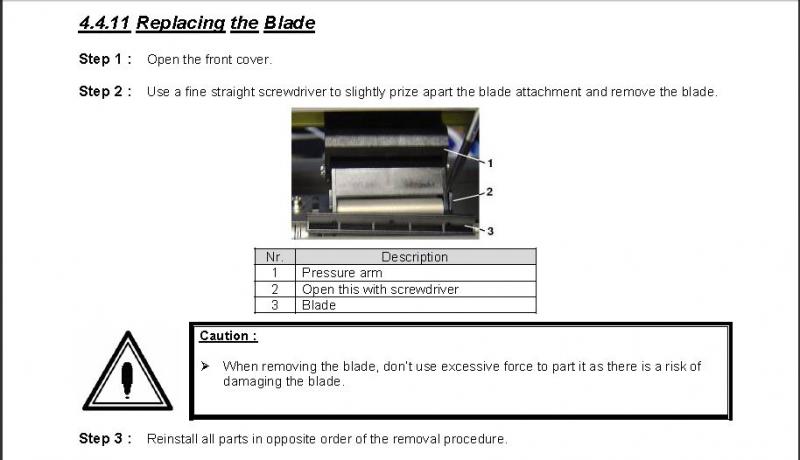

I do have another problem while I was working on one 8290 machine at a customer's site their other machine jammed on vinyl the lever lifted and they moved the carraige and it broke one of the pressure roller levers. It is one of the rollers right over the paper drive roll. Has anybody had to replace one of these. There is absolutely no information in our service manual about how to put a new one in. I would appreciate any information you might have about how to do this. Thanks.

Would this helps?
Paco
randya
The rollers themselve just pop in and out.
Part of the arm, fits over a hex shaft and would require removal of all the rollers on one side of a broken one to remove and replace.
ferkkila
Thanks for your responses, better than the info I had, but they broke the arm that holds the roller in, I think I have to replace the whole thing.
