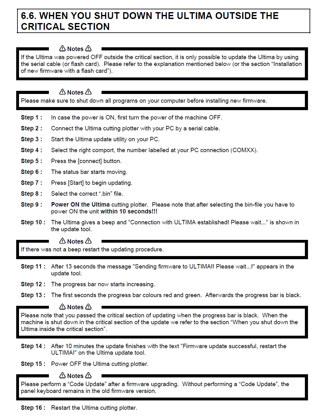

Another option - update with COM port cable by attached manual for critical situation.
Umca I read that in the manual, but that’s for situations outside the critical areas correct? My issue occurred inside the critical area, that’s why I am assuming that I need to update with the flashcard. Are you aware if the *.pcc file is downloadable from the Mutoh FTP? Thank you and your help is greatly appreciated.
