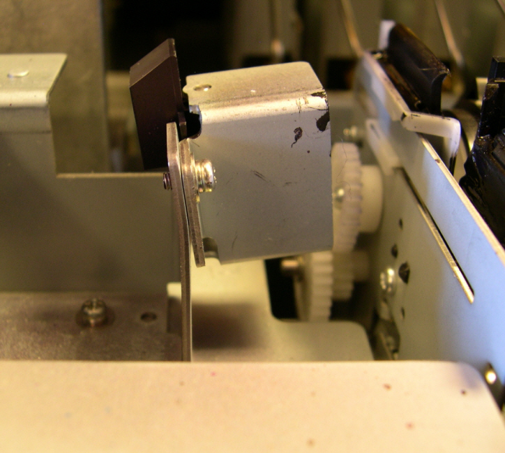

Is the error always near the capping station? I would check the plunger that holds the head on the capping station. I will get bent slightly left and hold up the head every now and then.
jiarby
Like this one... I bent it back and was fine. Then a year or so later it was clipping the head again do I used masking tape to hold the black plunger down.
Recently, while working on my capping station, I just removed it all together.
randya
Unfortunately the 074 CR2 error is kind of a catch all error code, and can be difficult to diagnose. So basically, if there is some otherwise undefined error occuring it will get registered under this code.
It can be as simple as a dirty t-fence, a bad motor, or even a bad carriage bearing.
I have even seen this error due to a dirty or warped pf encoder as well.
Or as in jiarby's case, the head solenoid lock mechanism.
chrisphilipps
Merchant Member
You shouldn't remove or tape this down, this piece keeps the print head capped, once the print head is in the maintenance station the printer relies on the head resting on this piece to keep it capped and without it the head will move to the left and will expose the nozzle plate to air. The printer will also not clean correctly because the head will move out to the left during cleanings as well.
