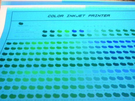

Now the real problem is here, the printer does its job when we send something from Flexi to the Mutoh it does everything right but it prints another layer on the print. Everything we send and even the test prints from the mutoh prints Blue. When we do a Nozzle Check it will print all the colors as it should but it also prints blue over it.
Basicly it prints everything we send and a blue foreground. We havent replaced anything before all the mess started, we had the mutoh working perfectly before an employee was fiddeling with the setting on the Mutoh and Flexi. We got every setting fixed on Mutoh and Flexi. We noticed that the prints we send are using the weaving mode but the blue forground is not using that mode. The blue goes accross the area of the art we send.
Can any one help me out with this issue? Right now the only solution we think is that the head is malfunctioning or the head cable is faulty.
One more thing we noticed that the nozzle check printed all the colors except one of the blue patterns. There are two blacks, two yellows, one blue, and two magentas.

USB is not supported. Try pinging the printer with the crossover. Make sure both ip addresses are correct. The nozzle check worries me. Has anyone opened the head cover or the back panel. I have seen odd prints when a wire is shorted.

You have a short in the circuit that drives one or both Cyan channels and that is why the F2 fuse went. If you continue to try and print you can damage the main board or the print head, providing that these are not the components with the short. Normally it is the CR Cables or Head Cables that cause the short. If you feel comfortable doing so check the cables for any damage, especially at the ends. If in doubt replace them as they are much cheaper than the main board or head.
With that said I would highly recommend getting a good tech to come and fix this issue since the motherboard and print head are so expensive, it is normally not worth it for an end user to play with it. I would also recommend changing the fuse back to one with the same settings as the original, they used the smaller fuse for a reason.
