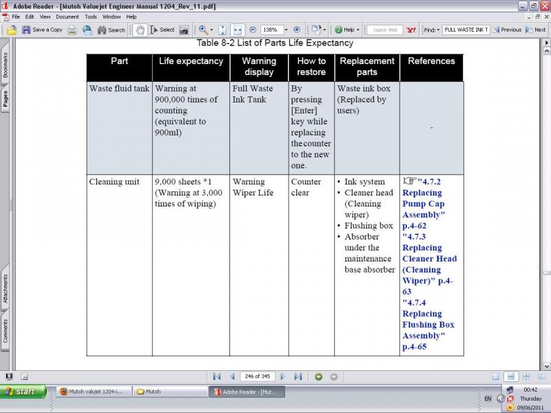

The printer "counts" the amount of ink through the system (approximately) by drops fired and rotations of the pump.
It 'estimates' that the waste tank should be full.
Open the door and that will trigger the sensor FatCat mentions, follow the menu on the panel to clear the waste tank full message.
If the ink drys faster than it goes in the waste, the waste will appear empty, though the printer will think it is full.

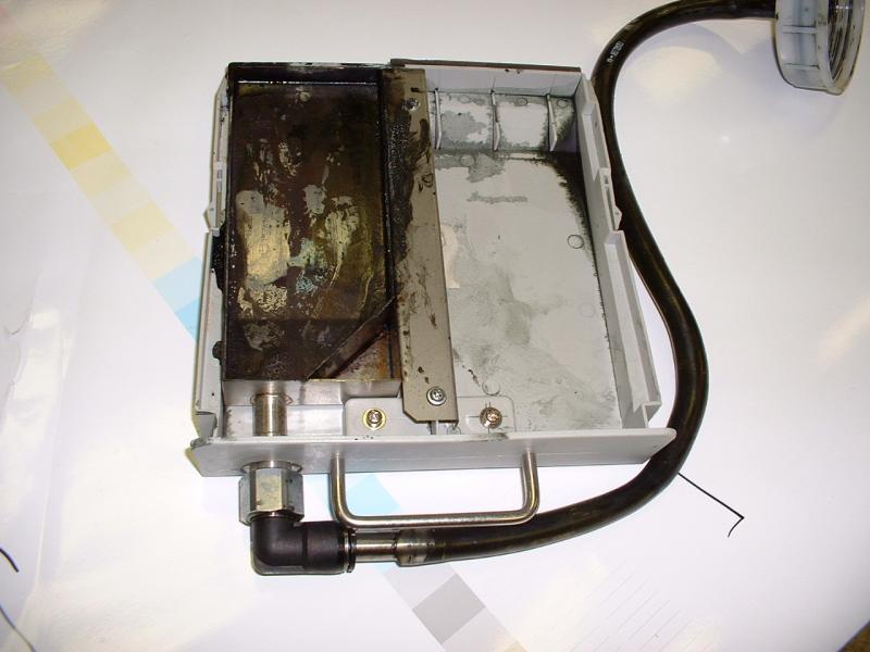

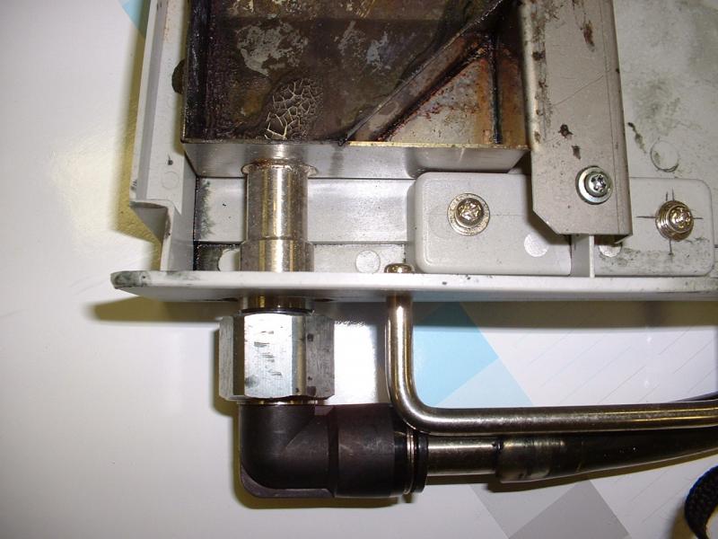

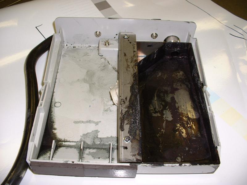

I would love to see a picture of the bottle setup. I have been threatening to do that to mine-- The waste tank sucks-- Mutoh was even going to put out a retrofit kit for that one time. But it cost to much.
randya
Here is one Mutoh was working on.
