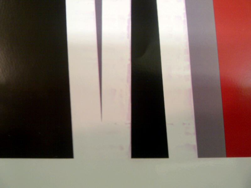

Our printer is leaving purple streaks across everything white on the print, we switched to a different ink after sign warehouse assured us that there wouldn't be any difference and this started happening around the time we switched. Does anyone have any ideas what could be causing this?

Sounds like you have some cross-contamination going on, Is the Check Nozzle Pattern correct?
or/and
You have some "fuzzies" hanging off the bottom of the Print Head and need to clean it...

A pic would help
It could be threads hanging off of the print head
free up the head and move it over to the right where you can see light under it. If you see threads hanging down then there is your answer. Banner material is especially bad for causing this problem.

In some spots its leaving streaks, like there's something stuck under the print head, but thats cleaned out. In other spots theres almost a "bleeding" look smeared across it.

It's hard to tell from my phone what's going on.
If you think it's something dragging across it, then most likely it is.
Check the entire bottom of the carriage. Print the same thing with your print head raised. If its worse when it's down then it's got to be a foreign object brushing against the vinyl. Usually stuff brushing against the vinyl is black because it's soaking up all colors. Good luck, post what happens in case anyone else has this problem.

I am more interested in the Check Nozzle Pattern. Are the 4 colors correct and do you see the the streaks in this this Test Print. If you have 2 channels of CMYK this would rule out cross contamination, If you see the streaks you have something hanging from the bottom of the Print Head... What you are describing is different issues... Do you have good ink-flow to the waste container?

Finally got it. Soaked the head for an hour and a half, did the stong cleaning twice and ran a couple of test prints and all looked good. Ran the first half of the wrap and it did a nice job.
