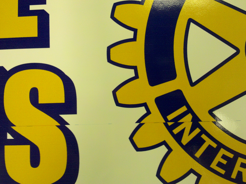

I don't know how to best describe this other than with pictures. I switched from machines running XP to 7 and initially had a problem with Flexi 8.5 and my printer just stopping mid-print. I (after advice from the fine folks on this forum) upgraded to the free update to 8.6 and that solved the print stopping problem, but now I have adopted this new fun scenario.
The 1204 is on my network and is being controlled by Windows 7 running FlexiPRO 8.6 and Production Manager.
I will add that before windows 7, I never had on lick of trouble with this printer at all. I have changed the entire maint station on it, but other than that, no trouble whatsoever.
Thanks.

is it reproducing the same error in the same spot multiple times?
Very similar error, but very rarely in the same spot. Different files, same problem.
