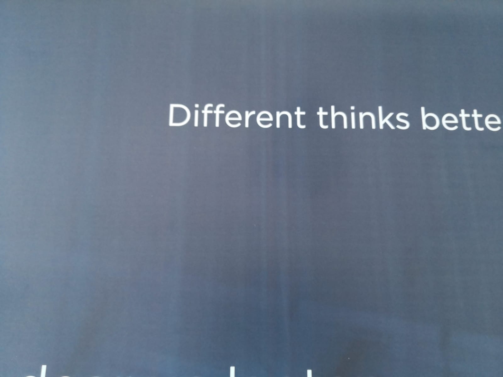

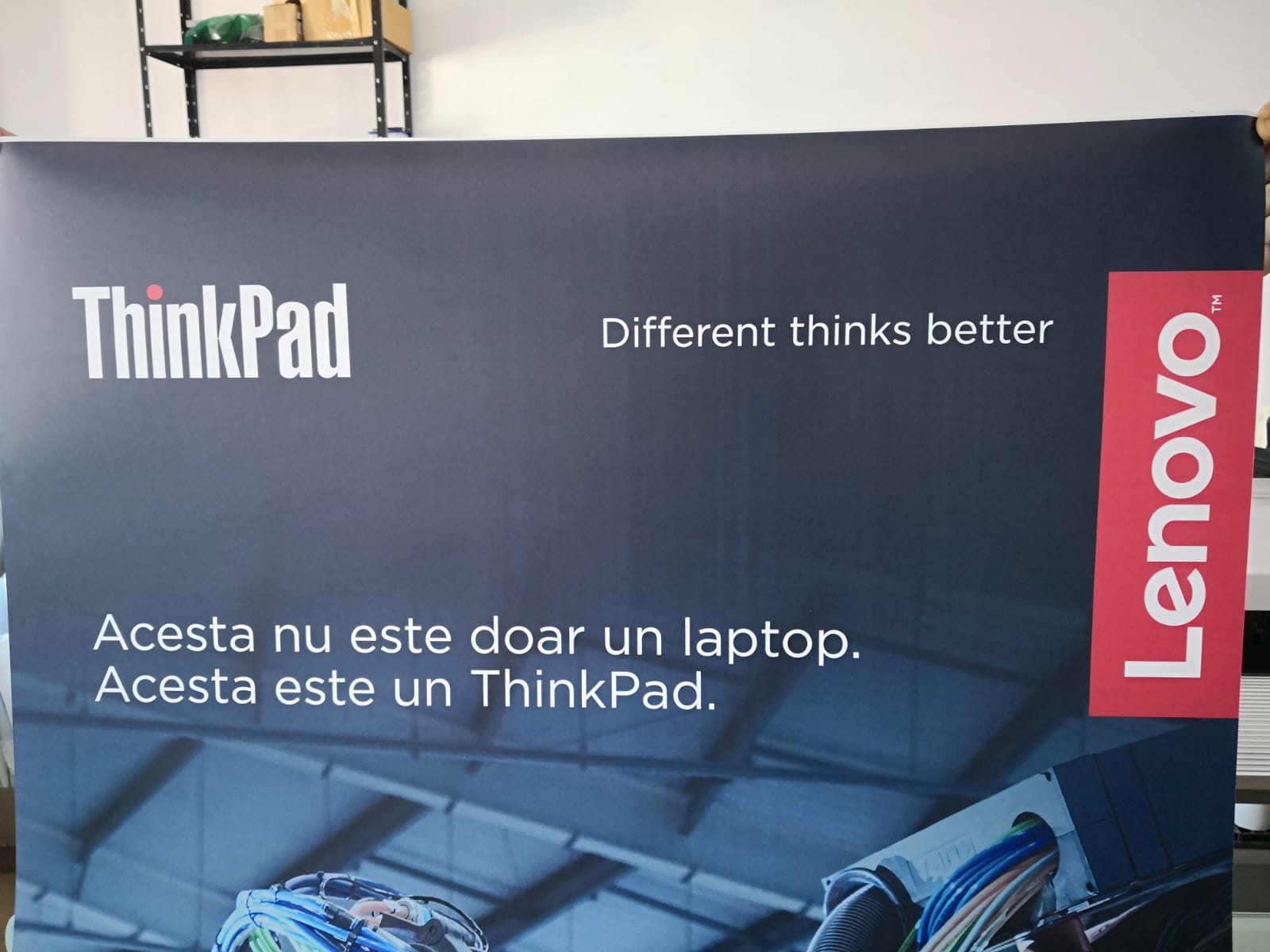

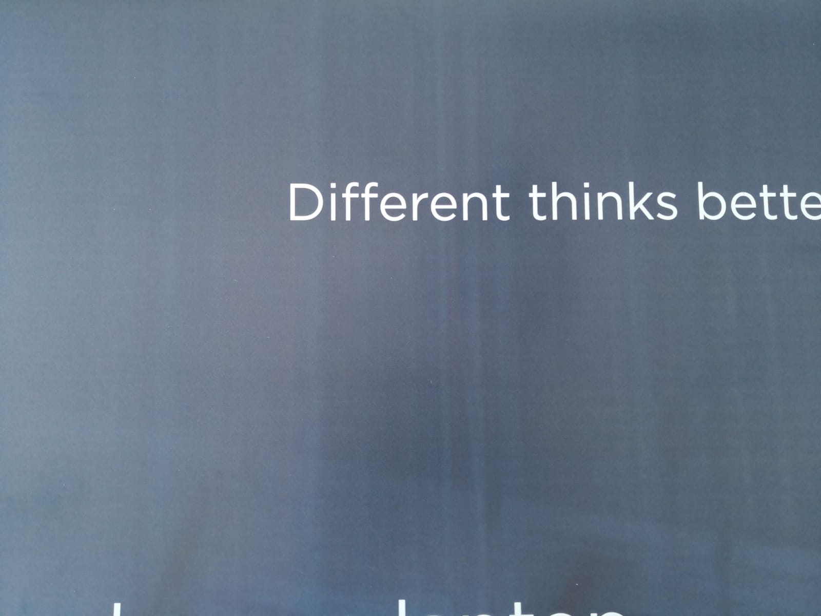

Hello,
I have an older Mutoh VJ 1624,
I noticed for a while that when printing, I have vertical bending.
The print head was changed one year ago, with a NEW MUTOH head, and so were the dumpers. The bending begun to show 6 months after we changed the print head.
I've attached photos of a print that i did today, and the vertical bending is present.
A technician came and cleaned the encoder, and the issue was not solved. The bending is still present./
Any suggestions?

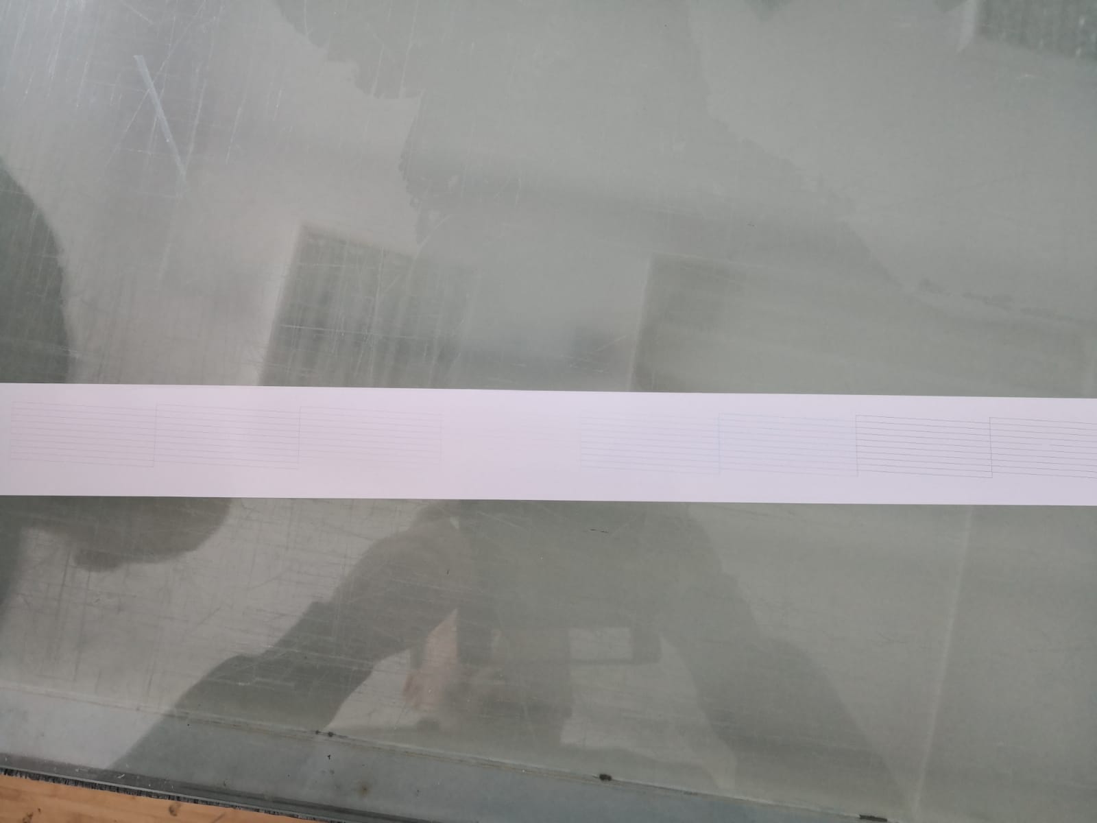

Did the tech run a nozzle check during the service call?
What does it look like? Post a photo if you can.
What else did he check or suggest?
Banding can be hard to nail down sometimes.
If the nozzle check is good, have you changed anything as far as materials or profiles dating back to the time when the banding started?
A run of bad material can look like that, is it present in all materials or just certain types?
Other stuff to check would be the heat settings or possibly a problem with static electricity.
Maybe run the head alignment/leveling checks - the head could have shifted or loosened up since the install.

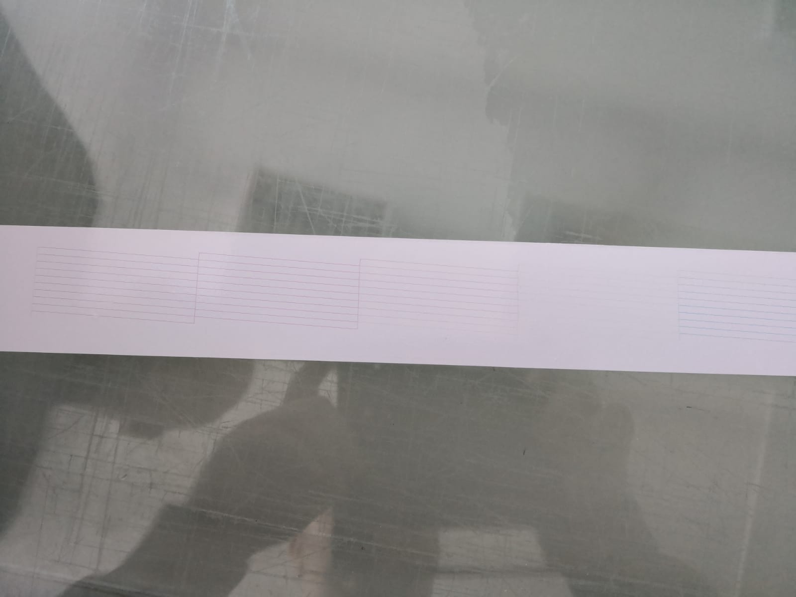

Sometimes the nozzle check looks like in the photo I've attached. (Look at the YELLOW!!!), but other times the nozzle check is perfect. I attached photos of nozzle checks that I got these days.
I haven't changed any settings, profiles or material. I have the same supplier, and the same brand of material (ORACAL).

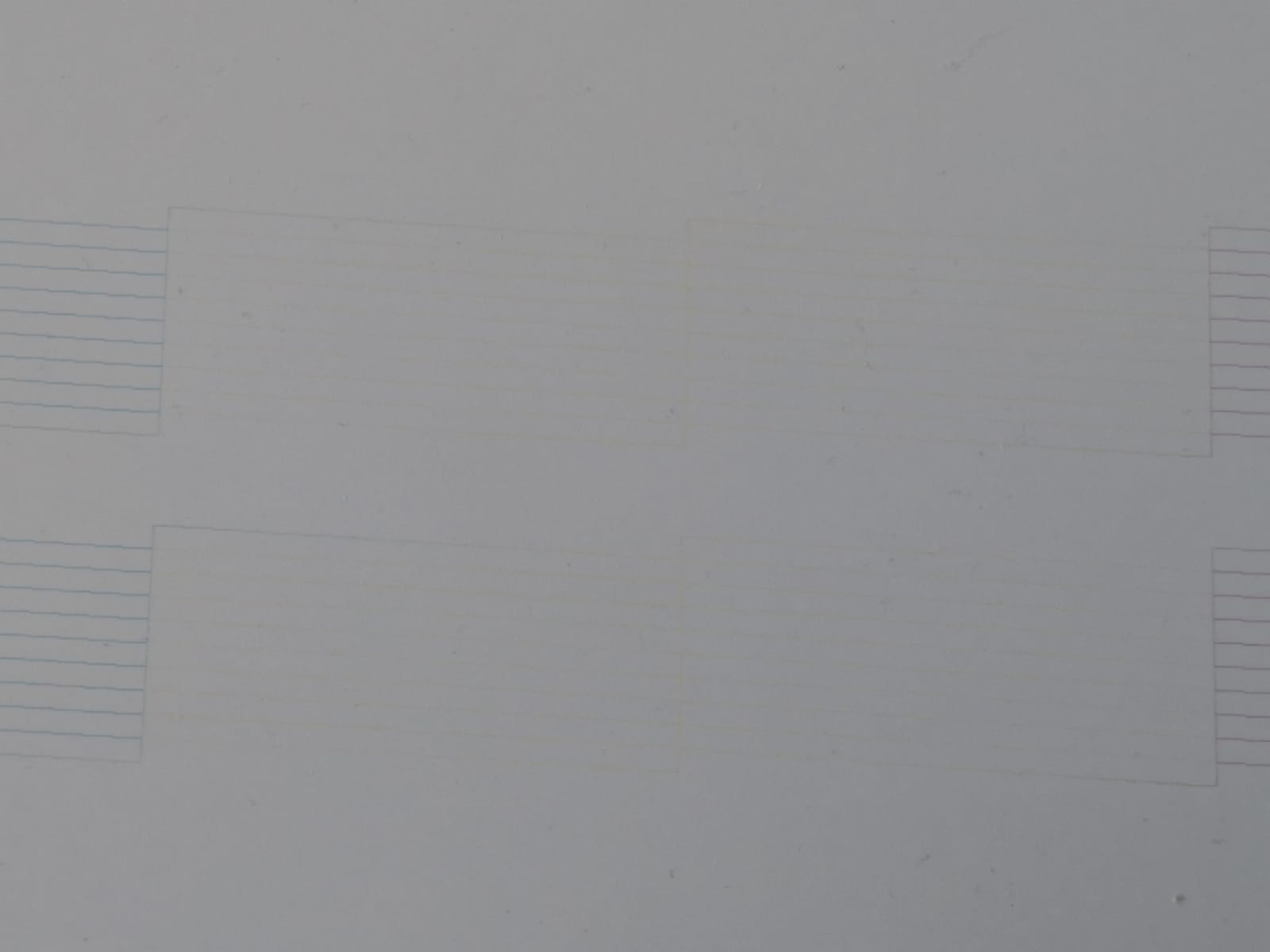

hello, i will try to change the temperature but my yellow isn't just barely viewable, sometime(see the photo) is not twoo grid, is just one and the other is red to . So, like in the picture is three grid's on red colour and sometime on the bottom of the yellow grid, one blue line a367e53d-3664-4008-91b6-cc3c989f2270.jpg apear

Looks like you have a bunch of cross contamination going on. When was the last time you changed your maintenance station?

I've came late, but whats the results of your problem. I've seen your photos and I saw very brightly cross contaminations as Solventinkjet mentioned. I've had this problem every time, that my maintenance unit starts acting up. Try clean capping station very preciesly with cleaner so the head too with cloth. After that run few long cleaning and check nozzles. This problem might causing blocked tubing that sucking ink from head to pump. In way away of pump, there are two tubing that are connected to same doubled tubes with very tight plastic hollow connectr. In this connecting part ink dryes out and blocking ink from getting away to waste tube outside printer. The pump in this point had small or zero negative pressure that suck ink from nozzles in cap. Try investigate wiper too. Wiper could be weared out. Wiper gets harder instead of soft by the time.

PF issue those bands. It happens for me with a humidity change and the vinyl gets funky, Don't bother doing the traditional PF adjustment you will drive yourself nuts.
You can usually get around it with changing the wave pattern - try Fine & Wave 2.
