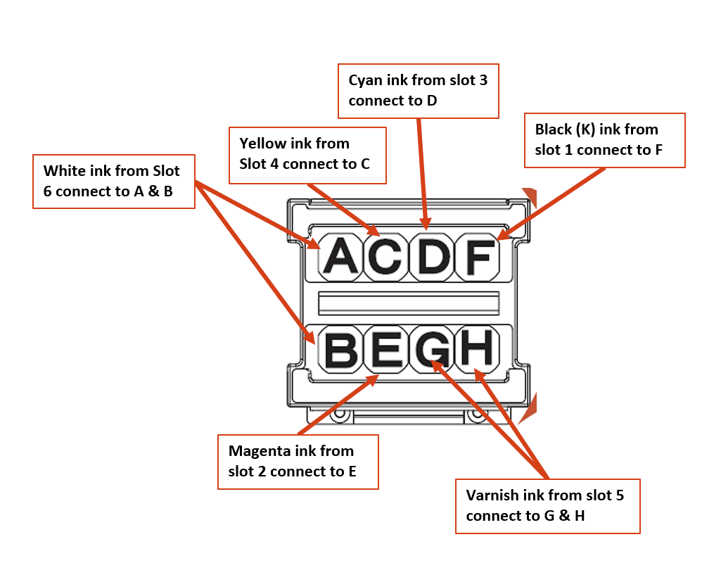

I just realized that I have another problem. Since this printer was damaged print head and tubes where all disconnected and not labeled. I am not sure what color connects to what print head connection. Does anyone know what color correspond to what letter? Varnish and white have to lines...
vova_28
Ok since I got no response is probably I am the first one to have such a problem. Well after lots of ink wasted was able to get it on the 3rd try. This is for 6 color configuration, I was able to see in manuals for a 4 color configuration but could not find anywhere for 6 color. The connection are as bellow hope that will save some time for someone else.
