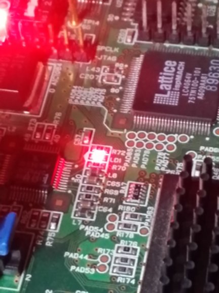

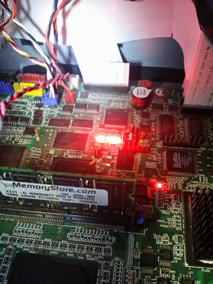

Took the board to the local cellphone repair since I didnt have the tools. Tested ok, wired the board back up and now I just get Red lights and no power to the display. Reading from left to right 2 reds 2 blank the rest red. Also, LD1 is red, and I get an LD1 flashing red on the next board over. I am ready to roll this thing into the street.

Got er running!!! Thanks to the guys at Solvent Inkjet for all the support. They recommended pulling out the memory stick, blowing some compressed air. Came right back up. Did a little charge and boom 100% nozzle. Beef Jerky time.
