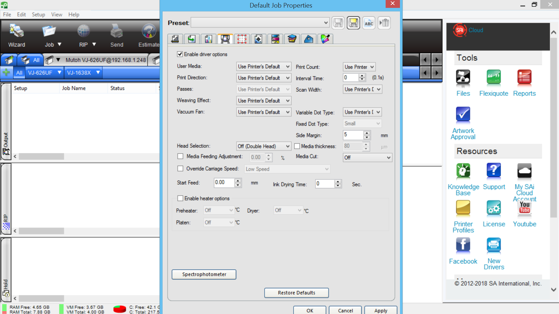

In Flexi, click on the printer tab, then click on scan width, you can select print area if you do not want the extra travel of the carriage
