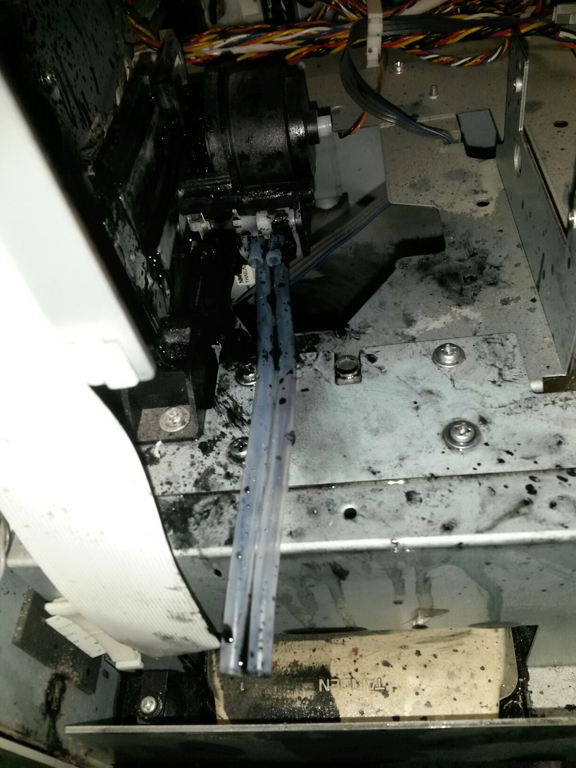

What is strange to me is why are both magenta tubes going into the head empty? Why would both dampers go bad at once? I guess because they are connected to one another meaning they are split from one main tube and if one has a leak, the other will be effected also?. Am I right? See picture:

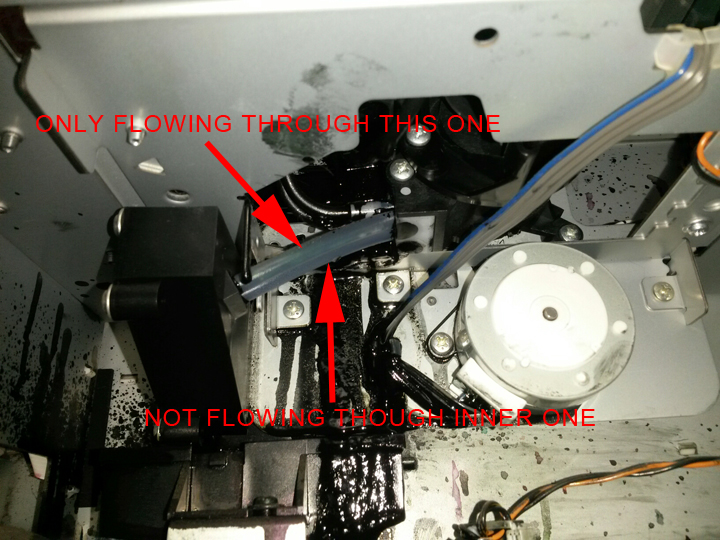

While doing a cleaning I noticed that there was flow only through one of the two drainage tubes. See pic. I have squirted some Mutoh cleaning solution on cap where head goes to rest on. Still no flow after another cleaning. Repeat process?

MagnetStew
With that much ink residue on the maintenance station it looks like you may have a broken ink tube inside the pump. That would explain the ink not pulling through the lines. You can either replace the entire maintenance station or just the tubing which would require you to dissasemble the pump. That is up to you.

I agree, or a thick clog. I did some disassembling and am directly injecting very low pressure air into the pump and cleaning solution and it still only flows through the one. I guess I need to take the pump off (two hard to get at screws) to further take apart the pump.

RG
I have a 1204 Mutoh and have had the same problem before. The maintenance stations should be the same, or close. I'll tell you what fixed mine. I used a 10cc syringe and tried to push fluid through the 2 pump tubes and just like yours, I could push fluid through only one tube. The other one was plugged badly. So, I used another 10cc syringe, this one was empty and closed, hooked it to the plugged tube that exits the bottom of the pump. I pulled it open and used a short piece of wooden rod to hold the plunger open. Then I used a syringe full of cleaning fluid, hooked it to the top of the plugged tube, and pushed. This way you have force working on both sides of the dried ink that's in the tube. This worked for me. You can buy a new maintenance station on ebay for less than $300. Also, make sure that the air-tube that is connected to the bottom of the cap top is not plugged. My 1204 has been plugged here half a dozen times over the past 2 years. When this air-tube is plugged, the maintenance station will not work right. Good luck and welcome to the Ink-on-the-Fingers Club.

OMG, you should see my hands! They will be ink stained for at least two days.
Looks like you had the exact problem as I do. I cleaned out the two tubes. Unfortunately I disassembled the pump and do not know if I am putting it back correctly. So I am thinking of just replacing it all. I am thinking about getting this one actually. http://www.digiprint-supplies.com/vj-1204-maintenance-station-assy.html
