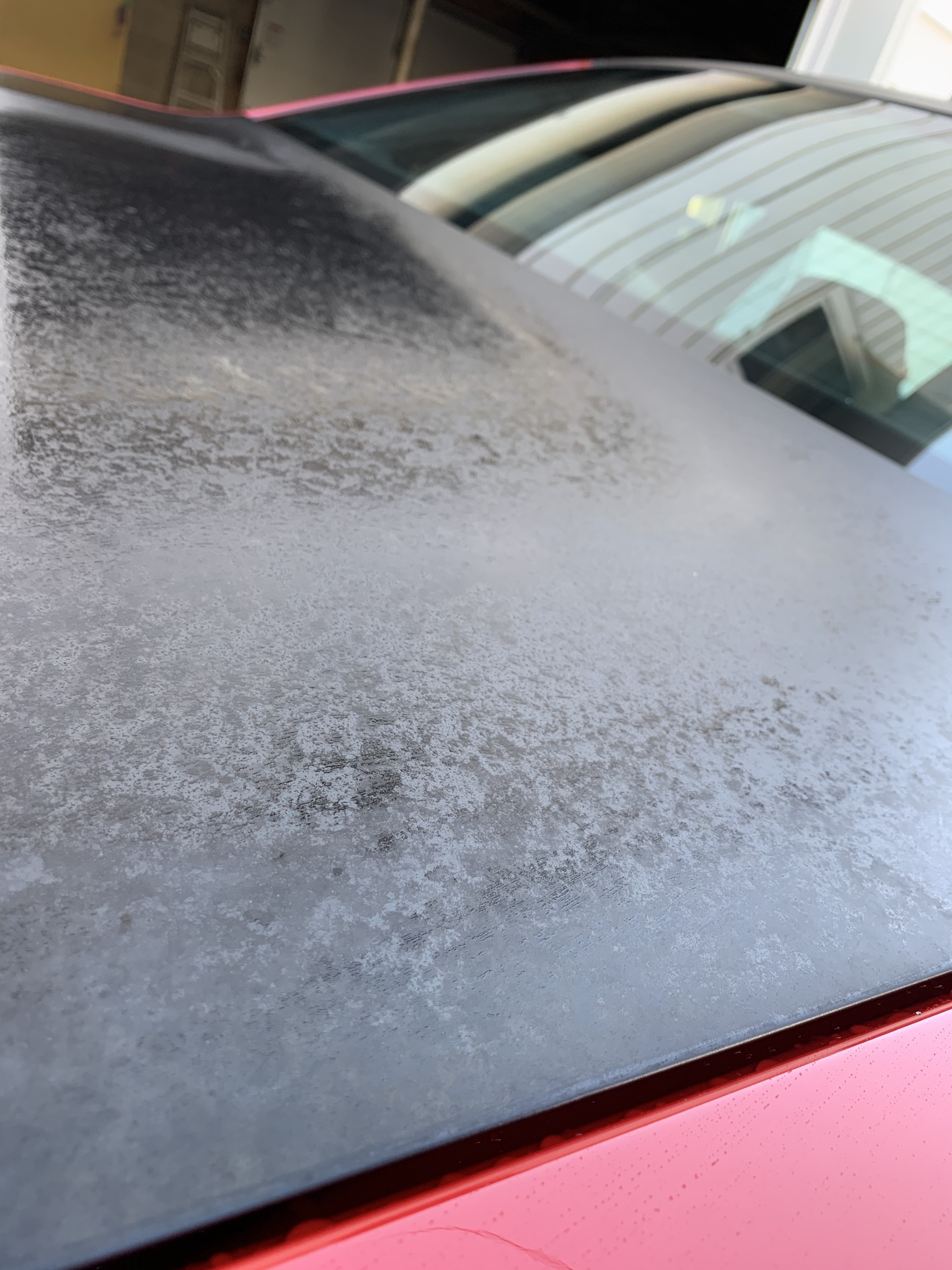

For some reason I cannot post a new thread and not sure why? I have a question in regards to a vinyl on a customers car. First, this came wrapped from factory. It is about 2.5 years old. Do you have any idea what this modeling is on the matte black and if there is a cleaner that would be best.
