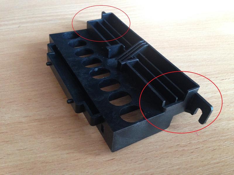

All this printhead have another manifold - you have to cut original printhead frame like on picture in attachment.

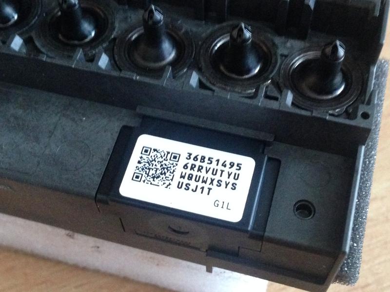

Head Rank containd some information for perfect working each printhead (voltages, mode for piezo, etc...) and use for fine tuning printing mode. This info collected while printhead produced and unique for each. These parameters can be coded by various format. So, Epson DX5 and Mutoh OEM rank foramat are different and you can't load Epson rank to Mutoh printer because printer will not accepted this. But printhead will work with any HeadRank. It can be not exactly same mode as recommend, but most cases you will not see difference for your eyes.
Attached Epson DX5 Head Rank. You can compare with OEM for sumbol quantity.

The only part that doesn't sound correct is cutting the manifold. In certain instances, cutting the manifold is not necessary.

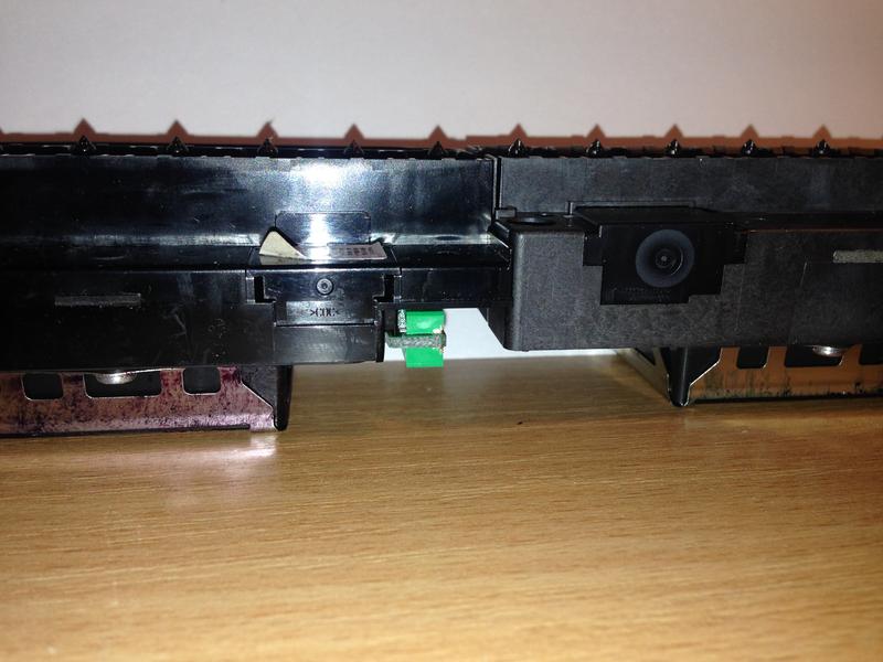

Sorry guys. Of coarse, the best way is use Original printhead from Mutoh. No any problem and all work perfectly.
But you asked about possibility of use DX5 from Epson on Mutoh printher. I am explained, yes, it possible. And price for Epson printhead two times cheaper.
On picture you can see Mutoh printhead (with green connector) and Epson. Thickness of front part of head cover are different. So, you can install original manifold without cutting. But with strong tension. And you can damage printhead or something else.
Anyway, finally choice is sub to you.

The manifold of Epson DX5 solvent head and manifold of original Mutoh head are different.
When users want fit DX5 solvent head on Mutoh VJ1604, have to cut the manifold or change a Mutoh manifold.
