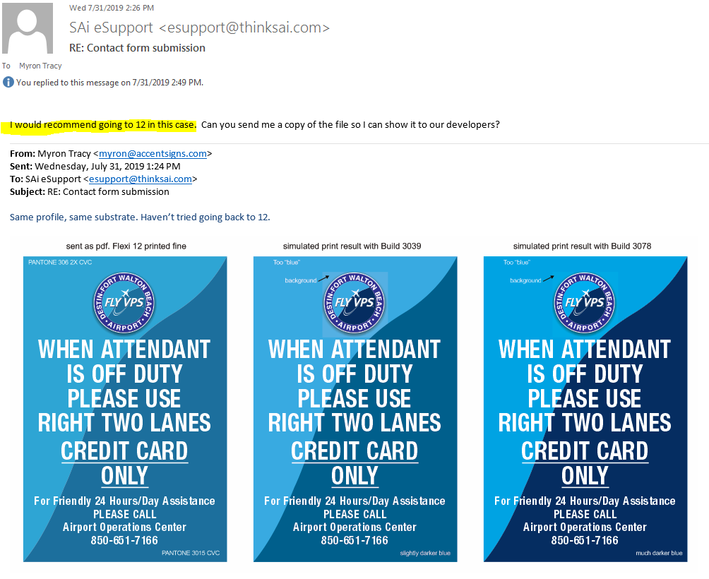

We also had to "roll back" to Flexi 12 for many of the same issues and on the advice of SAI.
How do you blame HP first for an update that flexi released? Doesn't make any sense. SAI told you to roll back their software because their newest software is bunk. SAI likes to test the software updates on the end user instead of taking time to beta test things first. Unfortunately this is much the same across the board in the software market these days. Release and then fix what doesn't work. If Snapchat made and update that didn't work with your current phones software would you be mad at the phone manufacturer? You would be mad at snapchat for releasing an updated software that doesn't work like it's supposed to.

If you have Flexi 19, there is a patch that may be necessary for running HP machines. Might give them a call on that.
Best bet is to create all new color profiles and possibly check that you're color settings in Flexi are right.
