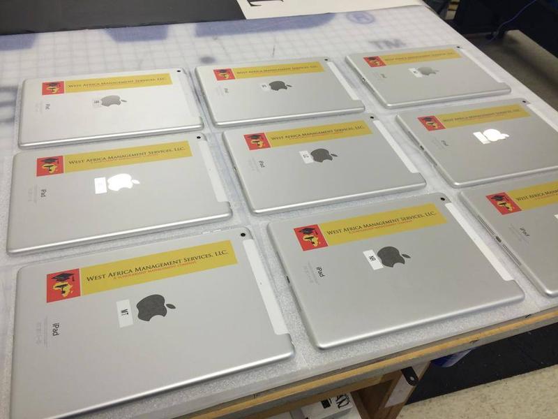

About a year ago we did these. Definite nail biter, but as said before, run a couple test sheets the same thickness as the Ipads to assure no head strikes. I use aluminum composite for literally everything, just make sure to bump up the DPI to photo plus or whatevers best.
greysquirrel
make custom media type on printer
photoplus
shuttered trailing lamp
low lamp power
2.0sec delay
1.00" height above media
yes to manual height thickness...
clean with alcohol first
