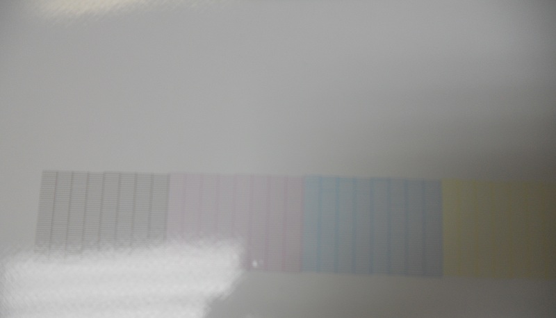

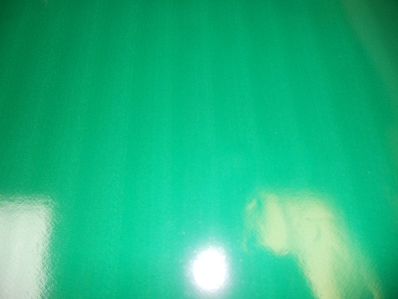

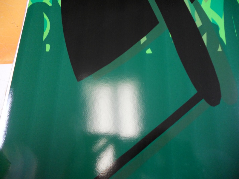

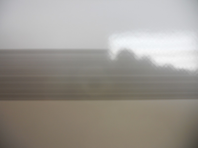

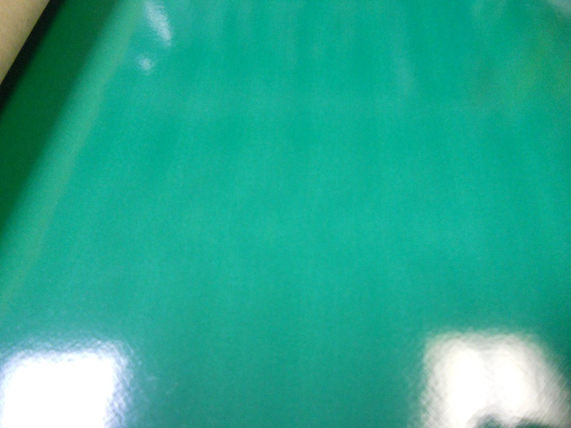

I've been through a bunch of other threads, trying many "solutions" with no results.
Our printer is about 4+ years old and has only had minor problems since.
Basically no matter what profile, media, or file we try to use we get crazy banding. Almost like "ink starvation" if i understand what that is. But we checked all the dampers and they seem ok. We also did a test draw and that also looks fine.
But when we do a media comp, it does not print solid gray bars. I will upload a pic of that.
We have used the recomended heat settings and have tried raising and lowering them with no difference except for the obvious vinyl buckeling.
This problem started about a month ago when we noticed it in burgundy type colors, but printing unidirectional fixed it. Now we went to print a wrap overnight on 3m Ij180c, and i came in this afternoon to laminate it. The whole wrap had terrible banding! I have to install this by monday afternoon or im toast!
I will upload some pictures and any help would be MUCH appreciated!

that does look like starvation. first determine which color it is. print large sections of c m y and k separately. see if some are banded and some very solid. do the test blocks in unidirectional only to eliminate lawn mower based artifacts.
after that there's lots of experience on this board on diagnosing where and why the issue is happening.
Daigleb
iSign: We have printed this same identicle wrap about a year ago with no banding what so-ever. We pretty much print on this machine most of the day mon-friday. We have had the yellow and magenta printheads replaced in the past year along with one of the dampers. We tried printing a sign that we printed 2 months ago (it was still upfront customer never came for it)and it looked fine then. We used our same profile and it now printed with banding.
artbot: We did print a sample of cmyk in bidirectional and the banding showed in all colors.. I wanna say black looked a tad bit worse then the rest..

signswi
Weird that a test draw would "look fine" but the media comp bars would not be solid. They should look normal if your black head doesn't have any clogged nozzles.
How are you profiling? When was the last time you checked the ink limits on the profile you're using with that media and/or relinearized?

Well we had a tech come in, and come to find out there is a little deflection in the black and cyan printheads and they need to be replaced. yikes! Also our vacuum suction is going out along with our heater!
We've decided to work with it until we can save up enough for a new jv33.
Thanks for all the support and advice!
p.s. We cleaned the encoder sensor and it actually did help some of the banding, but theres still the banding from the 2 shotty print heads.
