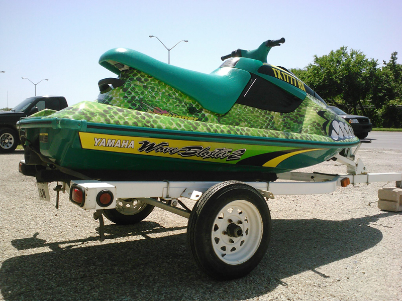

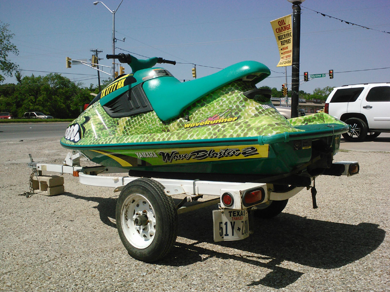

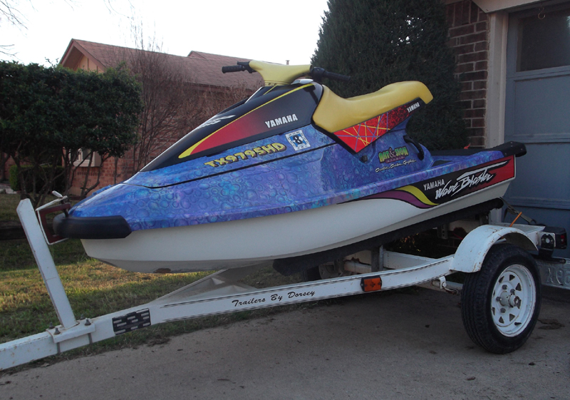

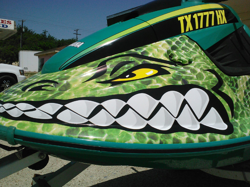

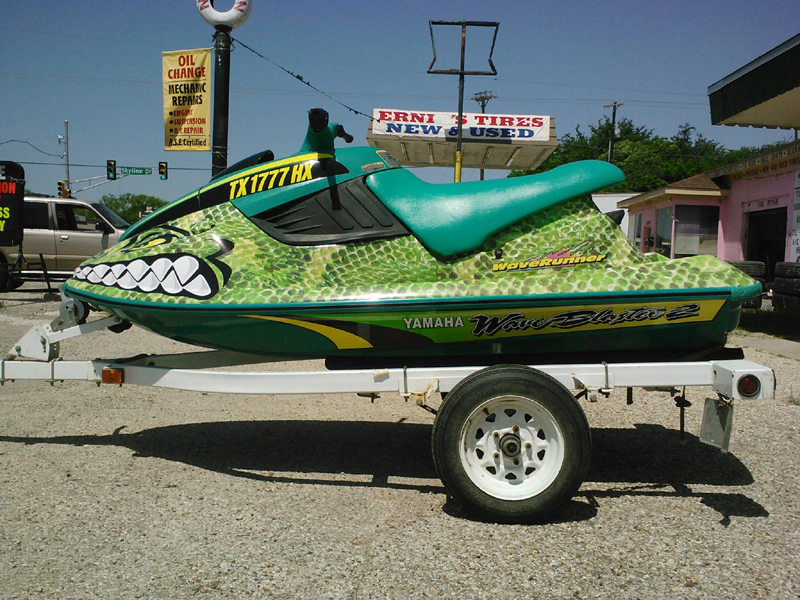

We wrapped my wifes Waverunner770. The purple one is my Waveblaster 700.
The wrap on it is about 5 yrs old. And it's almost warm enough to take them
out!!!

Nice job! What kind of film did you use for the wraps?
Orajet 3751 RA w/290 laminate. The stuff is a pleasure to work with. But we
did not get by without a few seams. The graphics were installed as a separate
layer. My old Waveblaster was done with 3951. A bit more challenging without
the RA feature. But any bubbles will smooth out over a short time in the sun.
