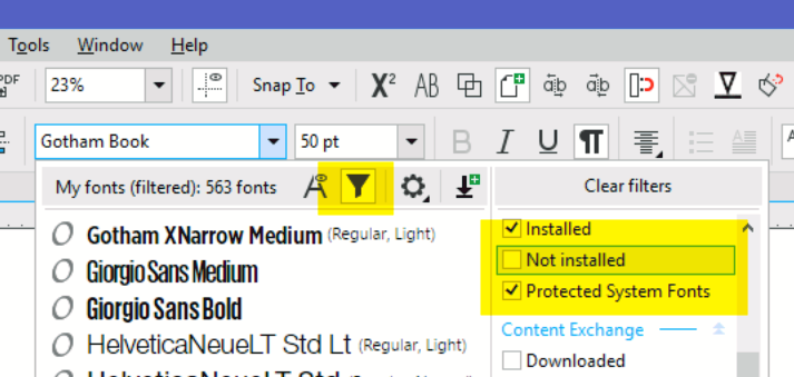

you have some filters for the fonts in corel 2017
it may be that uninstalled fonts are showing on your drop down menu

Make your font settings as the attached and all should be good.
